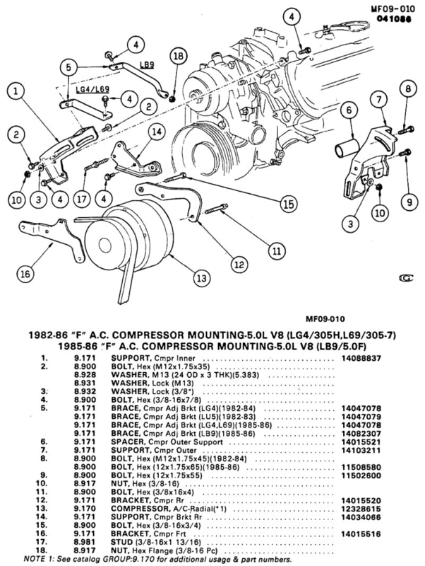

I purchased with my 1985 Trans am the ac compressor already removed and now im at a loss how to install it, Im a beginner so im unsure how to hook the belt up to it or how to tighten it once I have.

2,8 and maybe 9 need to be loosened up. When tensioning make sure you have about 1/2 belt deflection.
