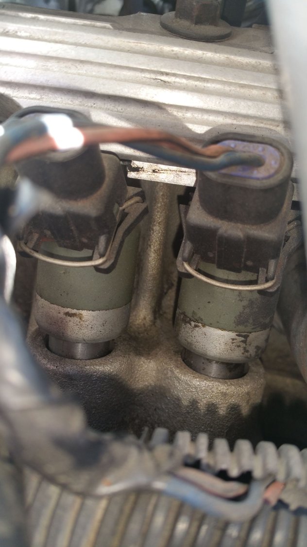

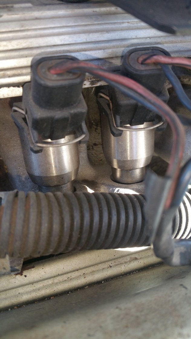

Looks like I have 3 different style injectors.. none of which look like the injector you posted about.
3 of them look like this
Only one like this
4 of them look like this

The multecs are problematic. For starter you might want to get a set from Southbayfuelinjectors.

Okay deal. Any idea why the previous owner would have 3 different injectors? And are these 22lbs or 19lbs injectors?
305 uses 19#hr, 350 is 22#hr.
