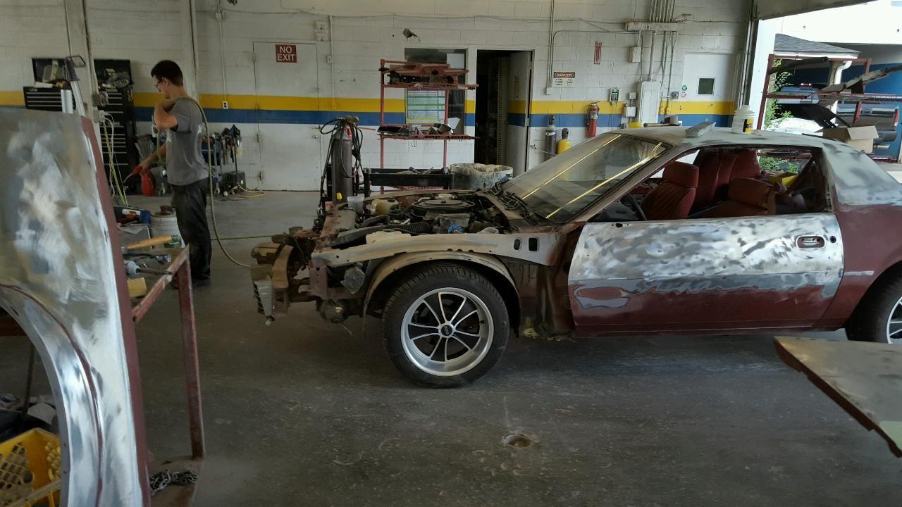

If this car is your daily driver, you're in high school and you make a minimum wage then a set of AFR eliminator heads and cam are pie in the sky thoughts. Myself along with many other members have "been there and done that," pouring all of your time and money into making a car fast when you are in the position you are in is not wise. I wish many times over I had only put money into making my car dependable and saved the rest for a time when I could do real modifications properly and I had another car as my daily driver. Take a look at Dennis' thread: https://www.thirdgen.org/forums/memb...z28-build.html
His thread is the same story as my first Camaro. We did it as best we could at the time and we end up redoing it (or scraping it in my case) years later.
