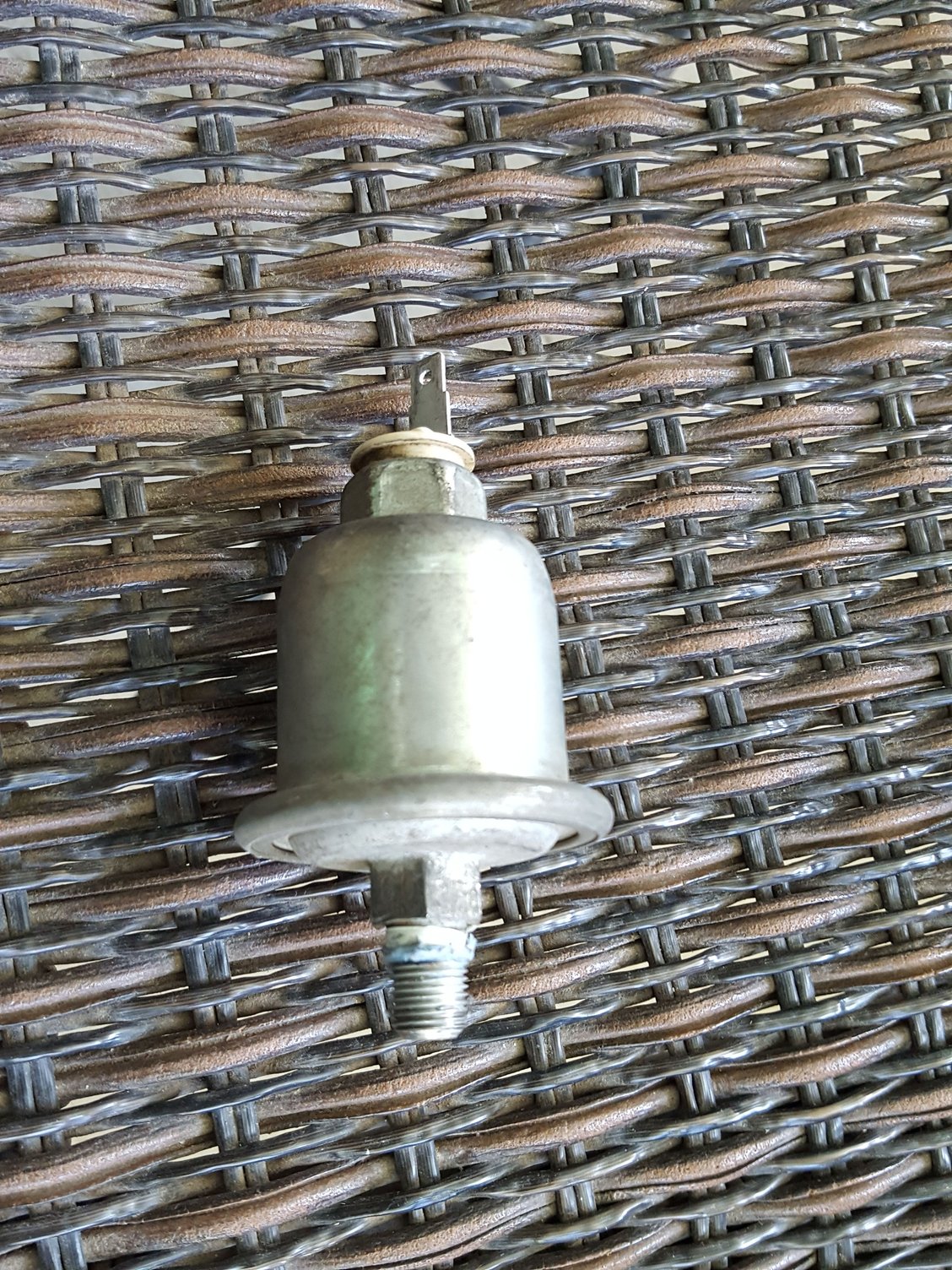

Is this the only oil pressure sending unit on a 1985 Z28 LG4 ENGINE? It was located under the distributor and I am not seeing a second sensor near the oil filter. Please reply.

Yep, single wire BRN/WHT

Looks like yours is a basket case...

Patio furniture, but I am digging basket. It turned out to be the sending unit and not a spun bearing!!! Thank you Lord! I went ahead and install a tee and 1" oil pressure guage as cowitness to the dash guage.

Yes, the oil pressure sender is a common failure point. Adding a mechanical backup gauge is a good move.

I was smiling like crazy when I seen that oil pressure at 40 psi!!!!
