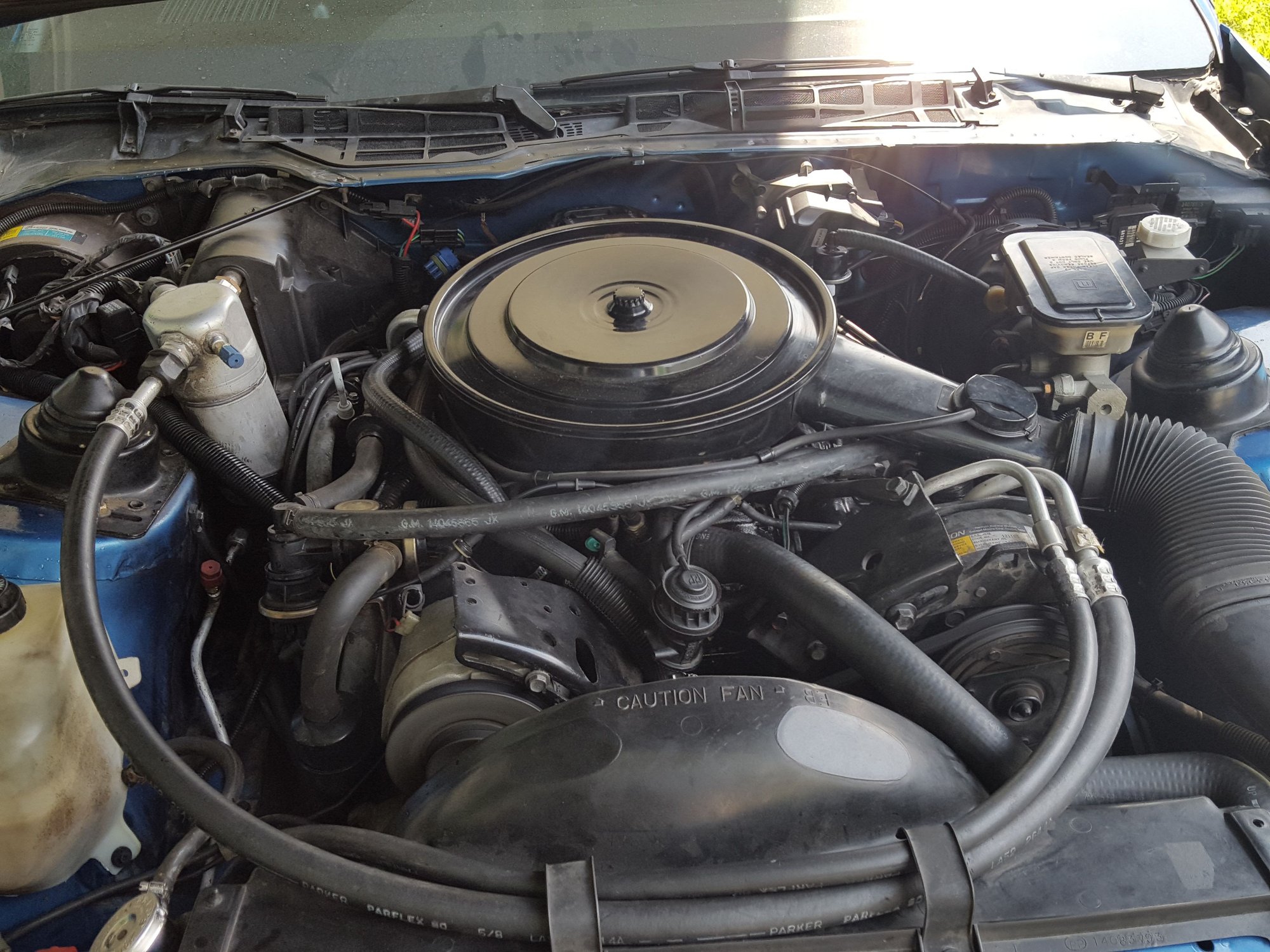

You can call me a Nervous Nelly, but I used 1 bottle of Lucas Oil and 2 Rislone "break-in oil additives" with 4 quarts of Rotella T 15W-40 followed by 30 minutes of varied 2500-4000 rpm immediately after start-up. So far so good on the Summit K1103 cam.
I will be cutting open a couple of oil filters in the near future

Old girl is smooth
