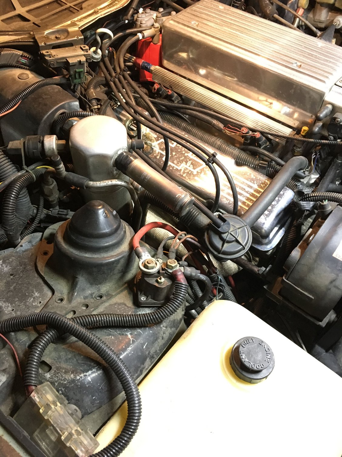

Dropping two cents to provide a pictorial representation on what I did. After my header install I cooked two factory starters and a power master gear reduction starter. (Power master replaced it under warranty ) Only things I bought were the solenoid and the pre made red battery cable.
I solved the heat related problems by using a "mini" starter (to put distance between it and the headers) wrapping the headers and putting a reflective blanket on the starter. Plus the solenoid. Been working for 8 years now.
P.S. don't judge me for the chitty looking install, I put it in when the power master went belly up in a gas station parking lot. Didn't fix it, went home on the second tow truck because the car was too low for the first one Lol
Mounted to one of the 3 passenger side strut studs
Close up of the wiring setup
