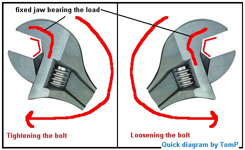

I tend to disagree a bit here... This comes from my experiences with rusted-up brake lines. Sometimes (as was just mentioned in the case of 16mm/15mm sizing), even a properly sized flare nut wrench can strip the tube nut!
If you feel the wrench starting to strip the tube nut, as would happen only with a rusted-up or overtightened fitting, STOP and get yourself a BIG- as in 12" or 15"- open ended adjustable wrench. Use the wrench on the tube-nut, and be sure to use it the correct way.
Seems odd to be able to use an adjustable open-ended wrench incorrectly, but it's possible. You want the brunt of the force to be against the fixed jaw of the adjustable wrench. It's a bit hard to explain in words, so I drew up a picture using a photo of a large Craftsman adjustable wrench. I'll attach it below. The adjustable jaw is only meant to take up the "slack" in the wrench; the force should mainly be against the fixed jaw (as noted by the red lines).
It seems that the large wrench, with it's long handle and thick jaws, has a tendency to break the fitting free easier. The long handle gives torque, and the thick jaws resist side-loading of the fastener. Remember too that you should always use a quick/hard force on the tool instead of a slow/"pulling" force. A slow and pullllling (or pushhhing) force can side-load the fastener and cause it to strip out. Hard-fast "yanks" will simulate an impact wrench, and jar the fitting free faster.
Another couple of suggestions for changing your fuel filter: 1, put goggles on. Ever see a Ford Mustang fuel filter? It's up "behind" the rear bumper, so, you got it, your eyes wind up directly below the filter. Way to go Ford!! On our cars, goggles would prevent fuel spray from blinding you. 2, put your wrenching arm through a black garbage bag to prevent gasoline burns. 3, never do this job inside, or with a hot exhaust nearby. 4, never drop any tools near your job- dropping a wrench onto concrete CAN cause a small spark! [edit] 5, I like to smear some anti-sieze compound on the threads of the tube nuts, AND on the ends of the tubing (where the tube nut rotates on to prevent rust.
6. Make sure the little o-rings are still on the extreme ends of the inlet/outlet tubes!! Sometimes these can get stuck in the old filter. If you put the new filter on and one/both of these o-rings are missing, your fitting will leak.
Fun fact (well, not so fun for me): On my first (original) AC/Delco pump, I never depressurized the system with any fuse. I'd remove the cap, undo the filter- never got a fuel spray- and wait until the gas slowed down and stopped dripping. Usually it would stop just as I started to panic. But, with my second and third (both Borg-Warner) pumps, the fuel NEVER stops dripping. Never! So there's definately something different internally with a AC/Delco pump then a BW (pep boys) replacement pump.
