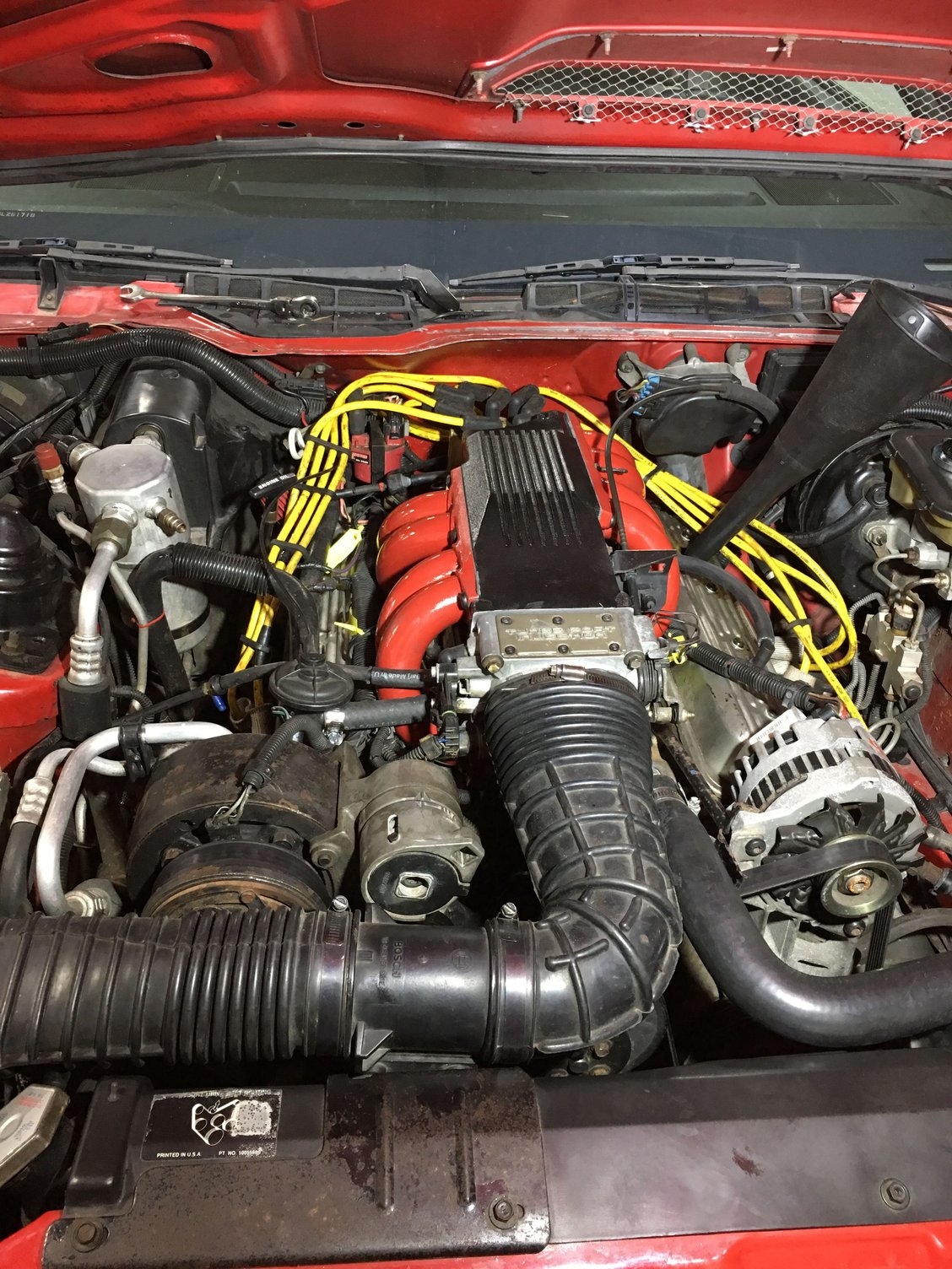

also, my buddy and I put in that oil luminescent stuff that shows where leak is coming from, and it is coming from my distributor. It's tight and snug. Also my gas tank bubbles on hot days after I shut off my car.

Get these:
https://www.southbayfuelinjectors.co...ctors-bosch-d3
What gauge are you using to judge oil pressure? The dash gauge is not acceptable as a diagnostic tool.
GD

Right on man. I will do that! Forsure. Also forgot to mention it's running really rich if you're 10 feet from car you can smell fuel. Instantly. Think it's them fuel injectors? They are aftermarket I believe.

If too big or stuck open injectors will cause a fuel smell. Are you using new o rings on the injectors?

The Southbay injectors come with o-rings. And in any case with a top feed injector, a bad o-rings will only result in fuel spraying on the outside of the engine or an intake air leak around the injector base. Which would cause the ECU to trim rich for a perceived lean condition.

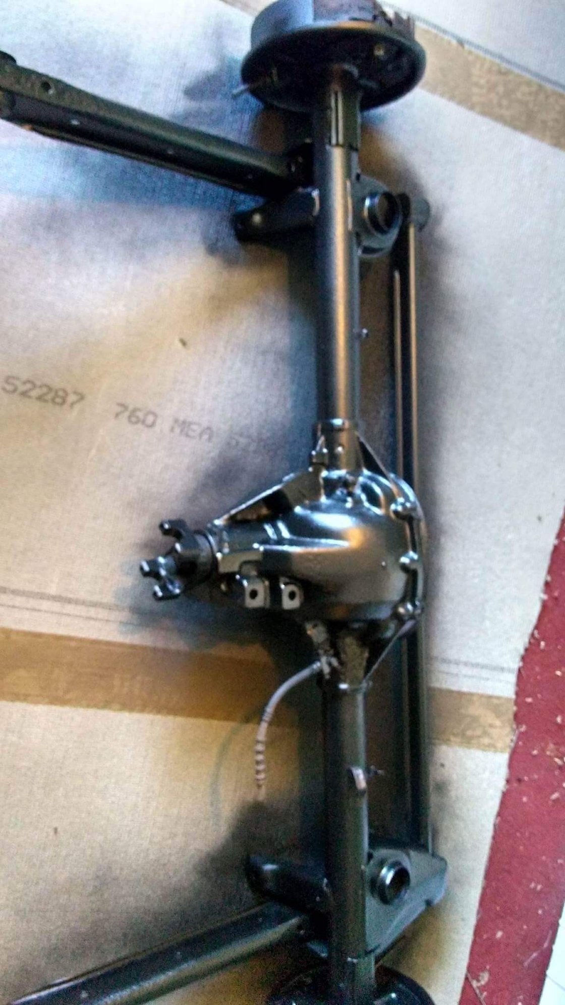

Did you keep the disc rearend?

I will check the regulator lines. And I don't have it on hand but it is retrievable. I wasn't either but these actually look decent. I will try to refrain. Lol
