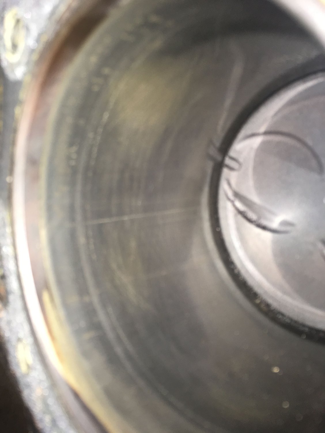

Was a V6 RS, bought a 305 TPI to install. I tore it down to put new gaskets in it, found vertical scratches on one cylinder.
I'm rebuilding this 305, to all the 305 haters. I asked a simple question. I'm not buying a 350. I just want a cruiser. In 3 to 5 years I'm going LS. By the time I buy new injectors, knock sensor, spark control I'll have 500 more into a 350 for 50 more horse
Had the engine been installed before you tore it down?
Visible vertical scratches aren't that uncommon, and may not be too big of a deal. Any other indications of a problem like low compression or oil use?
Again, a rebuild may not be justified. Need to have more information about the scratches you found. Most likely it'll be fine for 3-5 years.

One cylinder has deep vertical scratch in it. The motor was pulled from a running car. But yes crank will also get checked out.

Run it. Wouldn't worry about that. Think about it - ring can't catch on a vertical scratch. I've thrown rings into more engines than I can count with some measure of cylinder scuffing like that. It won't make a bit of difference - that's what? .05% of the sealing surface? Won't make any difference at all. Check for major our of round, taper, and hourglassing. If it's within say .001 - .002" or so. Run it. Won't matter. Cast iron rings and womp on it WOT from 30 to 60 mph at least 10 times. Cylinder pressure seats rings. Vary your cruising speeds for the first 50 miles. Will seal up nicely.
GD
Especially if you're going to be LS spendy in 3-5 years. The 305 will last that long. Use the new gaskets, seal it up and start pocketing that money.
BTW, that piston top looks awfully clean for a used, running engine.

If you haven't torn down the bottom end, put it back together and run it. If you've torn it down, throw it away. You'll have nearly $1,000 in reconditioning rods, new pistons, blah blah blah- For a 305.

The latest recommendation (after updated information from the OP) is run the 305 without rebuilding it. Given the statement that an LS swap is 3-5 years down the road, doesn't make sense to spend part of the swap funds putting anything into the 305 other than putting it back together.

*I* would do cast iron rings (no hone), the valve stem seals, and a complete gasket set and Cloyes double roller timing set. Just to avoid oil consumption or smoking and give it best possible resale value in 3-5 years. A trouble free engine that doesn't use or leak any oil is a must IMO. Cheap insurance.

Note that his "cross hatching" is much too flat. So definitely don't follow that pic....
But seriously - you don't need to do that. Don't touch the cylinders. Just rings. That is one of the WORST ideas that people do for no good reason that they can explain because no one that does it has ever tried not doing it - if they had they wouldn't do it or recommend it.

I re-ring hundreds of motors every year. Turbocharged applications, half of them are. I've never had one burn oil.
Honing should be done - as the last stage of a boring operation to bring about a proper plateau hone finish as recommended by the ring manufacturer - in a proper honing machine that matches spindle speed to stroke speed.
