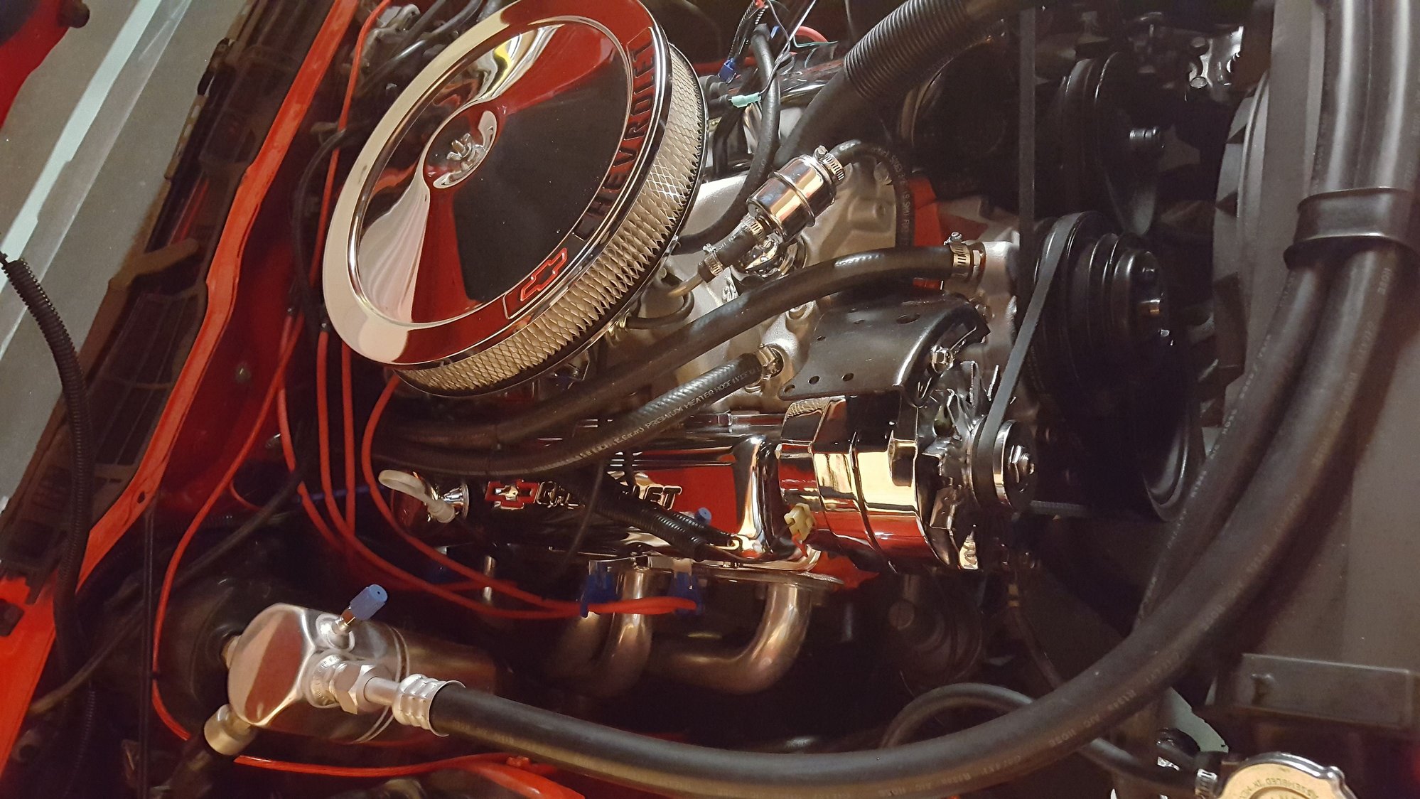

The best thing you can do for that 305 (after the basic tuneup) is the full exhaust. Ya it gets pricey but its worth saving up for and doing it right, once. I run those hooker shortys on my 350 and previously my 305, they are great with the y pipe, cat delete and 3" single to stock style muffler. I run a magnaflow, im sure flowmasters sound good too. The cat delete is if you dont have smog restrictions in your area.
Im running an edelbrock 14" x 3" filter with an 1 1/2" drop base. They look like K&N and are cleanable but are a dry filter so you do not oil them. They have a white strip on them so you know how dirty it is. I like it, not sure if it works any better or worse but it looks pretty good!
