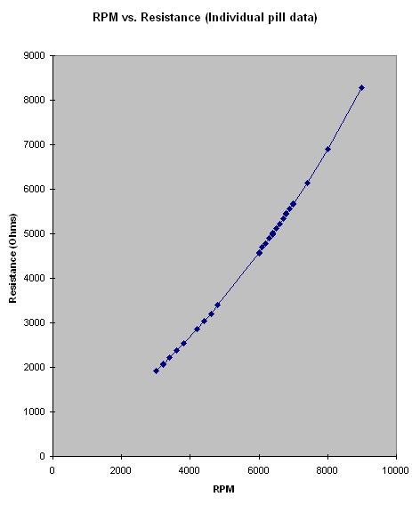

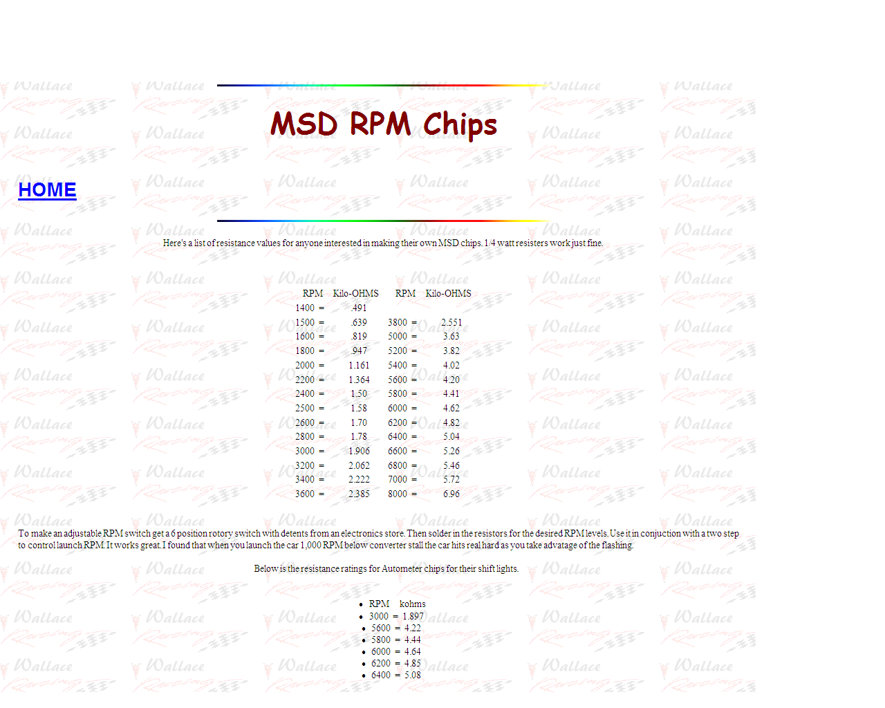

Originally Posted by AlkyIROC
The 6AL gives you a high end rev limiter option which most people would never reach during normal driving operation and you need to buy the chip with the rev limit you want or at least the adjustable chip so you can easily change the limit.
Those expen$ive pill chips are nothing but fixed resistors.
I attached charts and graphs so you can make your own pill for any rpm you want.
Attached Thumbnails Thinking about ditching the MSD ignition-chip-resistances.png   Thinking about ditching the MSD ignition-msdboxfixedrpmchips.jpg
