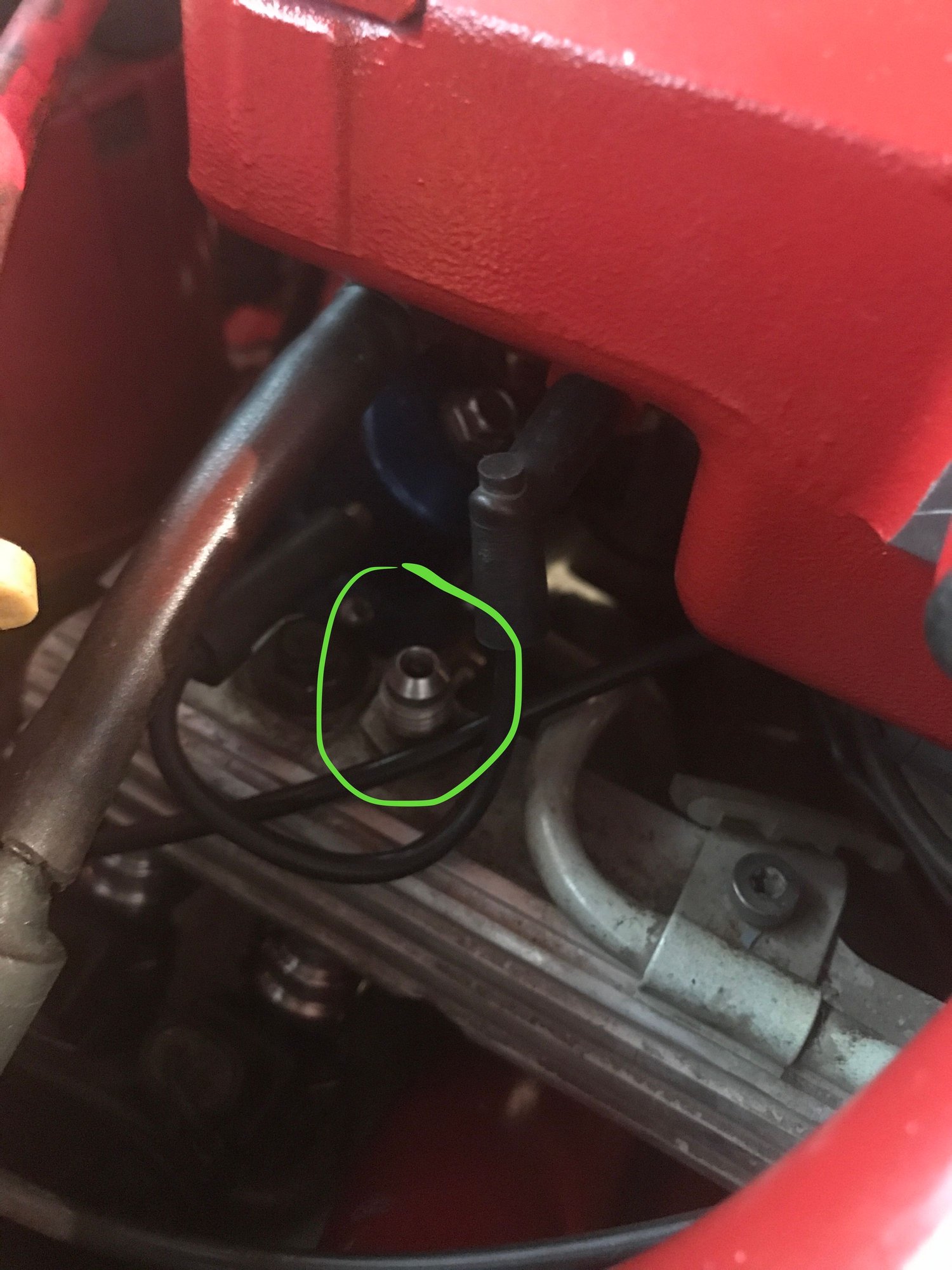

Am I missing a cap or something, that actually has a purpose, toward the back of fuel rail on passenger side?

Its a test port.
Usually there's a plastic or aluminum cap, but it's not unusual for it to be missing. Kind of like the valve cap on a wheel. Some people never put the cap back on.

If you can't find a cap of another gm 80-90s car in the junk yard a an 4 cap will work.
