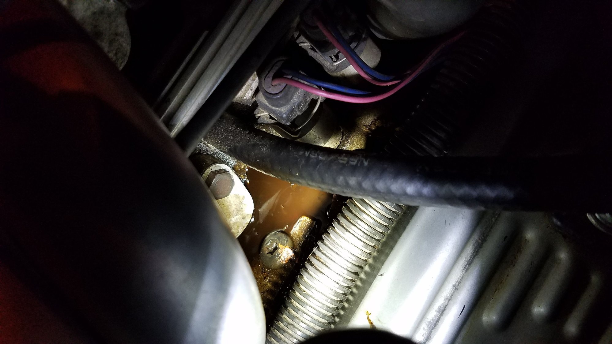

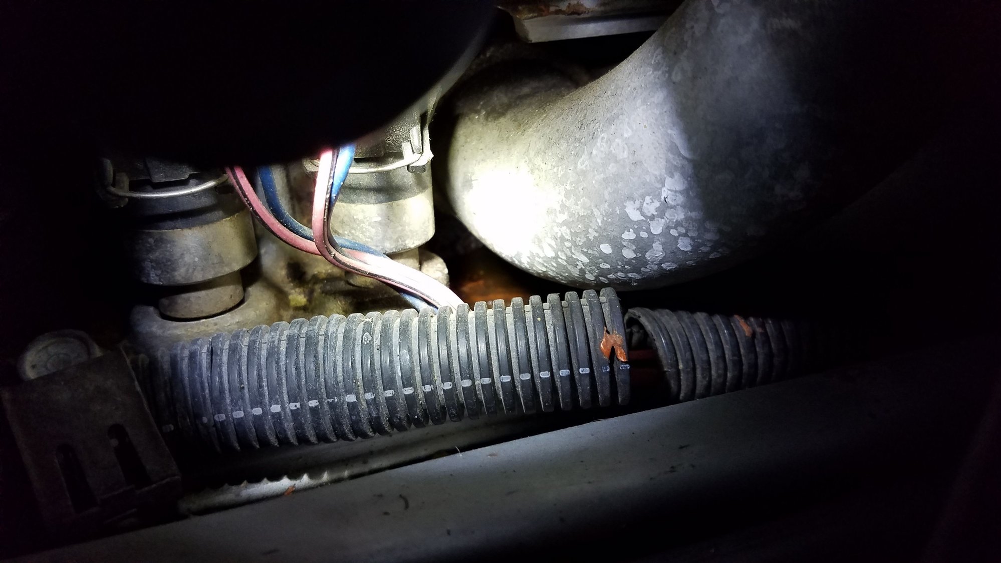

I don't know what it could be
You can see it just under that runner

i think it might be antifreeze mixed with dirt because when i was cleaning it up i saw green on the paper towels

Most likely, check your hoses for any pinhole leaks that might've shot antifreeze up there. Otherwise if it is an oil leak next to the fuel injectors something's very wrong

definitely dirty antifreeze, no oil is up that high on the engine. check your thermostat housing gasket or the coolant lines running to the throttle body
