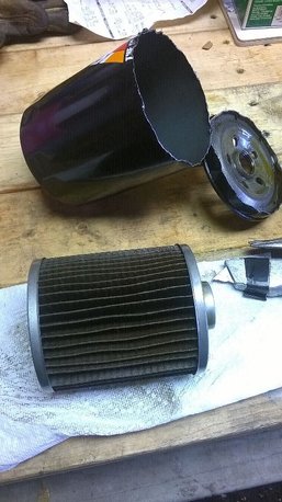

Or more specifically, a home grown method.
I tried the tin snips as posted in the video attached. To tell the truth, I have NO idea how that guy even started the snips into the filter case. There's no way my Wiss cutters were going to get through the rolled over seal at the top.
I'm very happy with this filter cutter - I've been using it a couple times a week for years:
https://www.amazon.com/Longacre-7775.../dp/B005S39PWS
GD
Then I tried my utility knife. Jabbed into the sheet metal and used it like a can opener and levered my wall through the filter case in about a minute. Slick.
Just a utility knife was all that was needed.

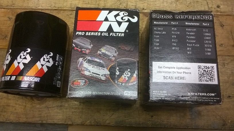

What oil filter is that? Looks like it has K&N markings on it, but K&N filters are usually white from my experience.

K&N PS-3002
I believe the K&N white filter you mention has a "nut" built into the case.

I've used a putty knife and a hammer but normally just cut it open with a hacksaw in a vise. A cutoff wheel in a disk grinder works well also.
My race car uses a System 1 oil filter. It just screws apart for cleaning.
Once you get the filter cut open, you can't just visually inspect it. You won't see anything unless there's some sort of catastrophic failure in the engine. Cut a chuck of filter out and squish it in a vise to squeeze the oil out of it. Then open it up to see how much metal is left trapped in the filter.

Yes, the K&N-3002 I use has the nut on the bottom. Makes filter removal soooo much easier. Don't think I've ever seen your version.
I'll do that thanks.
I CAN see some metallic flecks and have manged to retrieve both magnetic and non-magnetic "dust" so there is obviously wear.
The chunk found of the magnetic drain plug told the real story.
So did the leakdown test.
What's interesting is that I've ordered these filters from two different suppliers and there is slight difference but a noticeable one. The latest filters have a slightly smaller outside diameter, to the point where the cup style filter remover I use is useless. I hope this isn't a case of a cheap off-shore knock-off getting to my supplier's shelves.

Magnets will always catch metal filings from the normal wear and tear of the engine. It's the non metallic stuff that can get trapped in the filter that you want to see. Bearing material, brass, bronze, aluminum, etc.
It's all softer metal but it can give an indication that something is failing.
