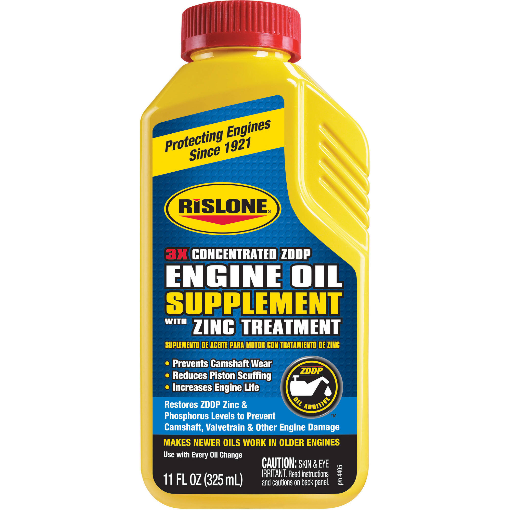

The story - short version.........
Zinc and phosphorus are what flat tappet camshafts & lifters have relied on to survive for 70+ years. Those are the anti-friction additives. Starting in the 80s, the EPA mandated that the oil companies begin removing the Zn & Pho additives because TRACE amounts would make it by the piston rings and shorten the life of your catalytic converter. So in their great wisdom, they made the oil companies keep reducing the levels at every new formulation (IIRC, SG was the last good oil) without telling anybody. Camshafts & lifters started failing widespread. So the federal government, in order to try to guarantee 100K miles for your catalytic converter, essentially removed all the good anti-wear additives in your motor oil. Now your vehicle sits in the junkyard with a blown engine, but the catalytic converter is just fine.
Any engine you have with a flat tappet camshaft needs the additive. Or read the bottle of oil you are considering to make sure it has the proper levels of Zn & Pho. Personally, I use the additives because then I know it's in my oil. Here are 2 additives:
