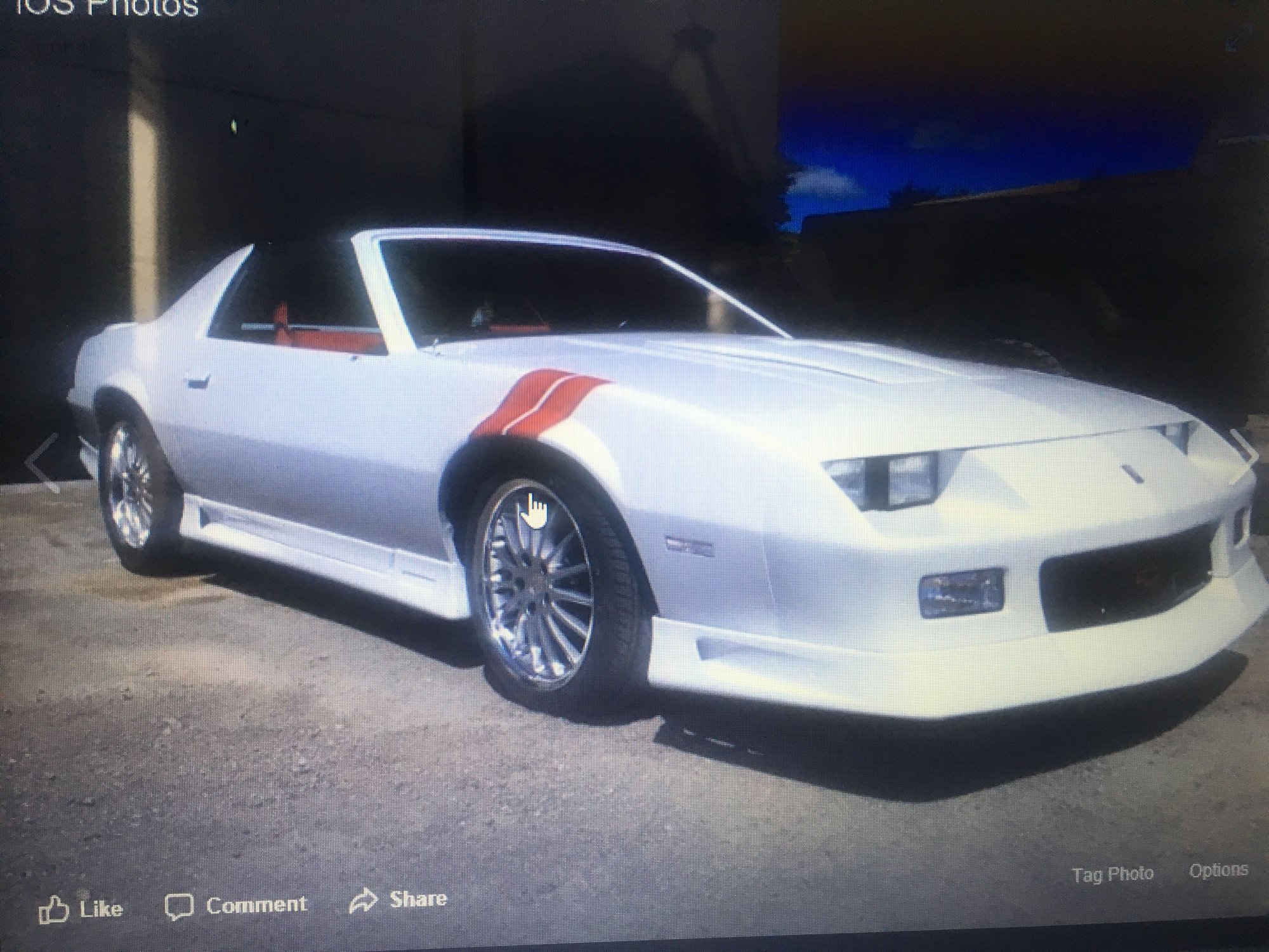

Went with the XE268....will keep the build posted..... .....picture after fresh paint...
