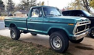

The distributor is a GM with a Ford lower end, and it is in a 76 F150. Im going to tinker with it today and try both sides driving; the left port retards the timing slightly at idle because there isnt any vacuum, I believe it opens up as the RPM's increase and the drivers is constant?
