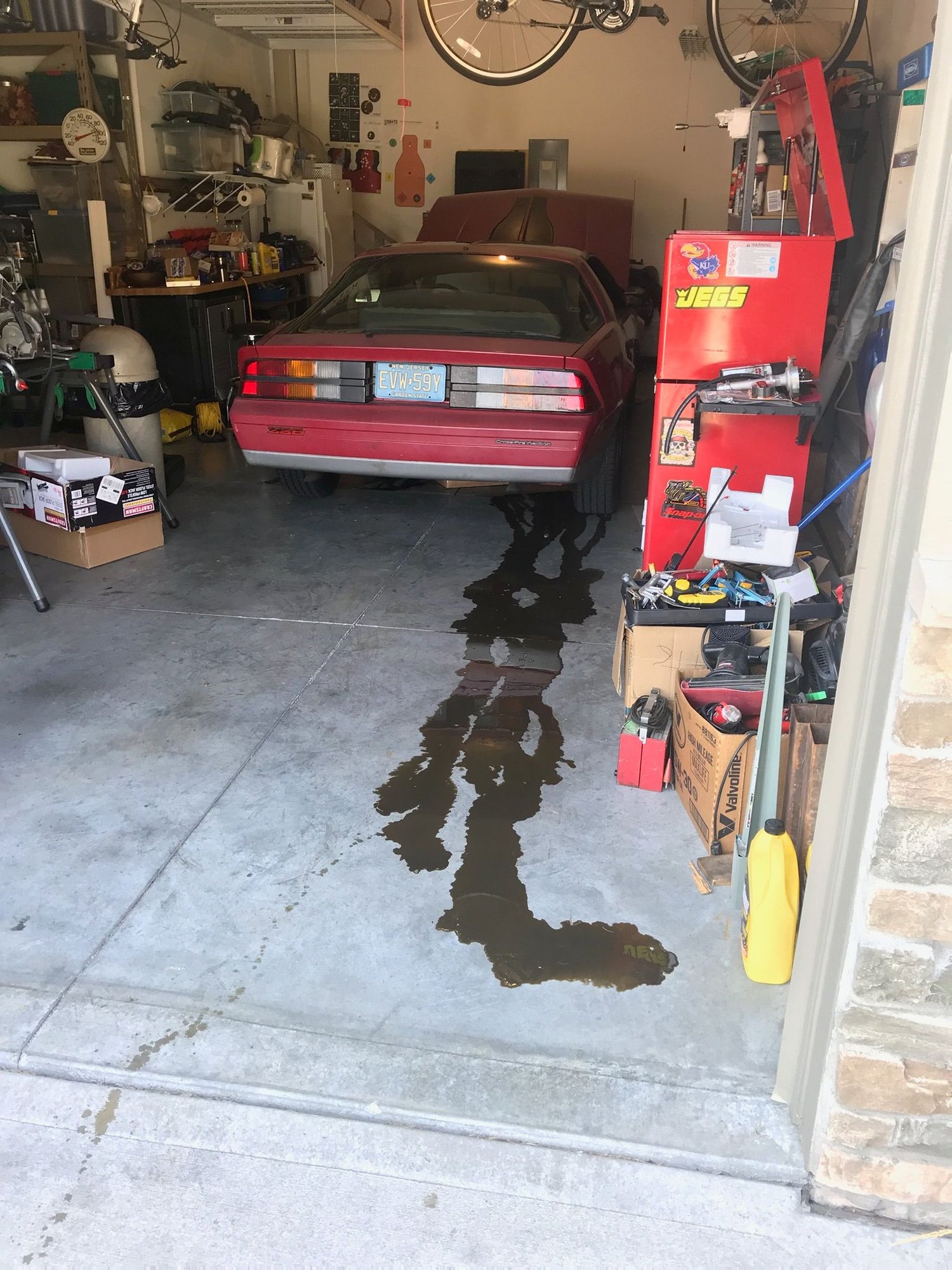

Well after working on the car at the bottom of my hill with no luck my dad and I hooked the car up to our SUV to pull it up to the top of the hill and just for fun I tried to start it and it started right up and I drove it back into the garage. We did not touch a thing it just came to life I honestly have no explanation for it and it still confuses me but I'll take it.
Today I cleaned off the ground wires just in case since that was a popular suggestion and then we decided to take it for a test drive in preparation for taking it to the DMV tomorrow. My dad wanted to drive it this time so he drove it around the block about 3 times and then took it into the empty parking lot of the church attached to my neighborhood and when he was parked revved it up a little and a spark plug wire that wasn't routed quite properly fell under the throttle linkage and held it open which held the engine at about 4000 rpm for around 10 seconds. My dad shut the car off and we checked what was causing it and noticed it leaking oil. The crankcase pressure must have blown either the timing chain seal or the front main seal and it started spraying oil.
So the car is gonna be out of commission for a while and hopefully I can find the issue and replace the seal before I go to college in 10 days.
