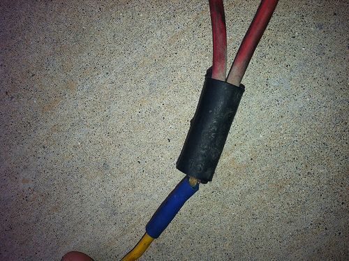

DON'T do what's in that photo... use it ONLY as a reference for what you're looking for looks somewhat like.
Each Big Red Wire needs its own fusible link. The links are sized according to the size of the wire they protect, and are color-coded by their rating. Generally the FLs are 4 gauges smaller (larger gauge #) than the wire they protect; so for example a 12 ga Big Red Wire would use a 16 ga FL.
AFAICR there are usually 2 FLs in these cars, and both are normally "rust" color, a sort of dull orange/brown, which is 16 ga. One for each Big Red Wire.

yes reference only. To show you what the pellet looks like.

The pellet is just a plastic shell molded over the crimp. The fusible link is the wire itself. When they go, the insulation usually melts and there's a flash of light, smoke, all kinds of good stuff... Never let the magical blue smoke out of anything with electricity. The blue smoke is what makes it go.
