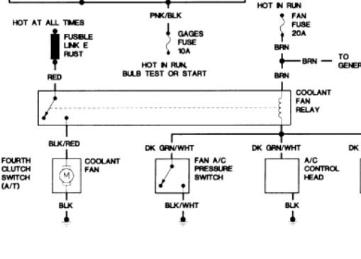

Start with looking to see if the fan works. With the key on you can ground the wire going to the cylinder temp switch. This switch is in the passengers side cylinder between cylinder number 6&8. If that doesn’t kick on the fan you need to look at the relay. Sorry I don’t have the schematic for it.

The coolant fan switch is cut off in the picture but is tied into the ac pressure switch.
http://austinthirdgen.org/mkportal/m...ine_wiring.gif
