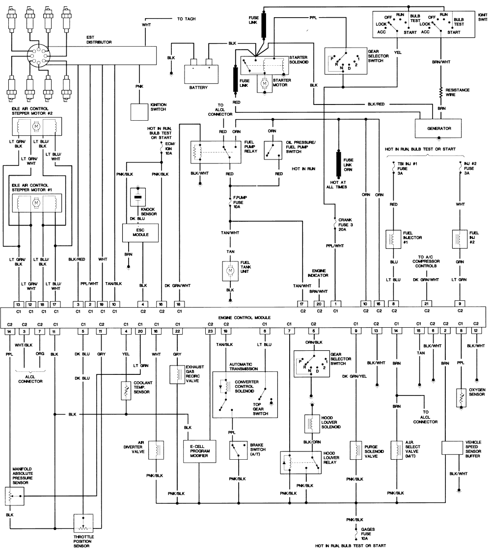

Oreo , your mission will be to restore the fan circuit back to it's factory state , my next post will include the wiring diagram for your engine ....

Since I don't know if your 1983 V8 Camaro came originally with a carb or the "crossfire" injection , here are both diagrams .
PS , if the car was originally a V6 , these diagrams naturally will not apply .....
