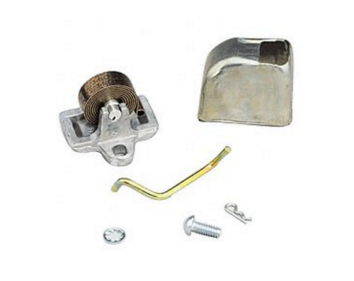

No. Those valves have a somewhat triangular base. The mounting location on the manifold I have looks like this (picture 6): https://www.jegs.com/i/Edelbrock/350/2101/10002/-1
Update: After speaking with Edelbrock Tech support, the port on the intake manifold is NOT used for EGR. It is intended for an air choke, which answers my question about it's design. Looks like I need another intake.

That’s for choke set.
maybe a 3701
https://www.summitracing.com/parts/EDL-3701/
