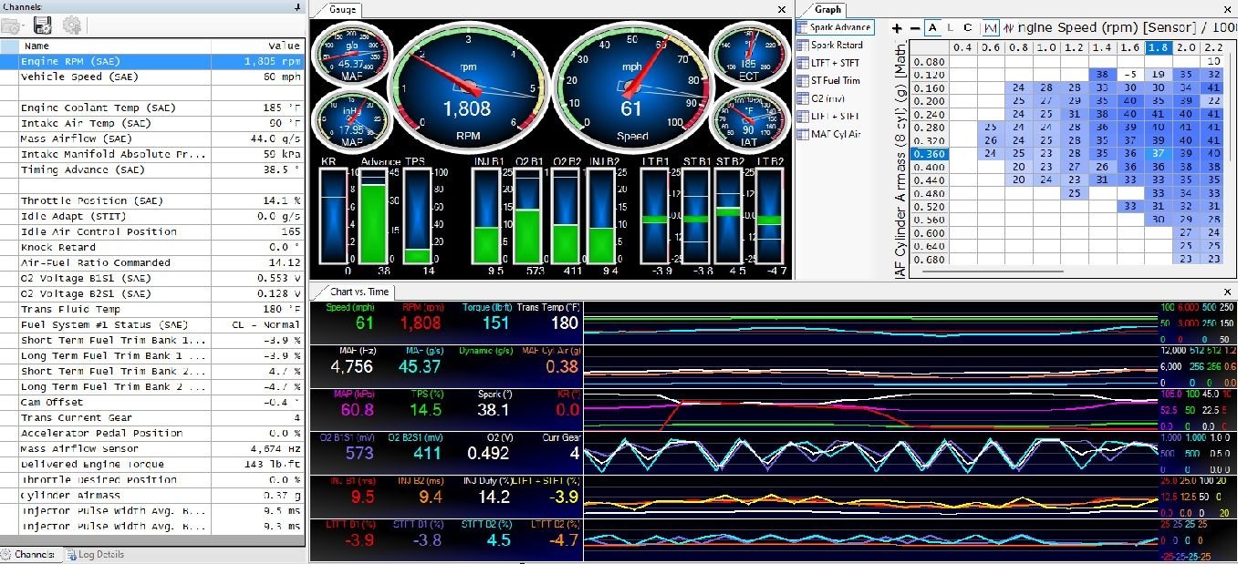

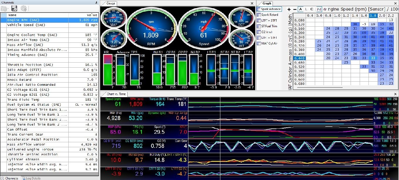

One other thing I have been doing is enabling lean cruise on every 24X LS based controller I have tuned that it is an available option on. This 6.0L cruises effortlessly at 16.9:1 air/fuel ratio. The 383 runs 16.5:1 at its leanest.

That in itself (the lean cruise) is worth the price of admission. I've dialed my 350 in to a 16:1 cruise as well. Problem for me is with the timing which, as you know, is a PITA making adjustments the old fashioned way. Mechanical advance. Vacuum onset. Vacuum total. Etc. It would rattle (almost imperceptibly) while at light throttle cruise. Perhaps to point of hurting the engine (which is something I've yet to determine).

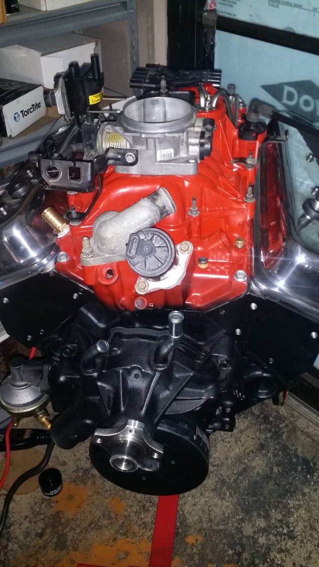

NICE. Here is a few pics of my test stand. A couple of differences between yours and mine:
I connect the cold water to the water pump inlet, and take the hot water out at the thermostat, but I use a garden hose shutoff valve to keep the block pressurized a little bit. The CW in is hardly flowing and I just monitor the temp of the HW out. Actually, I fabricated piping to replace the water pump. This way I don't have to run any belts --- for safety. But before the engine is actually installed, I put all the accessories on so I can check belt alignment and functionality of everything I can.

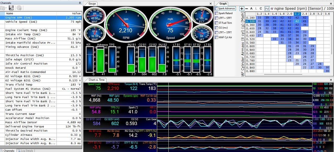

I know this is an older post but have another update. The electric fans were a bust, ended up swapping back to a stock dimension radiator and the factory fan shroud. Added an 11-bladed motorcraft fan for a 2006 5.4 3V F150. Its quiet and pulls great CFM.
Yesterday evening I strapped my 97 Express on a friend of mines dyno at his shop and ran the snot out of it for close to 5 hours. It was 104°F and felt 112°F when I was playing around. Luckily my van has ac that will freeze you out of it especially sitting inside the shade of a building.
I made about 20 WOT power pulls on it from 1,200 rpm to 6,000 rpm with the torque converter clutch locked and the 4L85E locked in 2nd gear. The engine ran the entire time without a care in the world. I have HP Tuners and a custom operating system that allows me to load and manipulate the timing and fueling with the engine running as well as save the revisions to flash into the PCM.
The fuel curve was pretty good as it was although I played with the WOT air/fuel ratio from 11.8 to 13.2:1 in 0.2 increments. I really like making several back to back pulls with equal increment changes like that. It is easy to lay the graphs over the top of each other and figure out what the engine likes and where it likes it as it can be a moving target. Around peak torque it likes 12:1 and about 12.6:1 at peak power.
Timing curve needed some tweaking. I initially started with 29° total at 3,600. Then moved up in 1° increments. Ran as much as 35° before it actually started losing power and had yet to ping or show any knock retard. Ended up finding it made peak power on 33° but it was only 2-3 hp more than it made on 31° that I was already running at on the street. Then I worked backwards on the low rpm end of the timing table that I will only really see in overdrive with the 2,800 rpm stall converter locked up. I made about 10 pulls from 1,000 rpm up to 3,500 to dial in the low-end. I was able to go another 4-6° in places before adding another 2° showed little gain. I generally run 2° less than where it makes the absolute most power for long term durability. My 31° total advance is now in at 3,200 rpm. I have 26° as early as 2,400 and 16° at 1,200 with 8° on the initial throttle hit at 750 rpm.
With a 2,800 stall converter I will never see much below 1,500 unless my foot is off the throttle because I do not lock the converter until the engine will be turning over 1,500.
With fine tuning, found an additional 18 ft/lbs average torque and 8 hp average hp gain between 1,200 and 6,000. At about 1,800 rpm I gained 28 ft/lbs. At the ground through a 4L85E and 3.73 geared 10.5" full float 14-bolt (no more 5.13s) the 383 ended up making 399 ft/lbs at 3,100 and 382 hp at 5,600 (Rhoads V-Max lifters and great flowing heads FTW) uncorrected on a Mustang dyno. It repeated those numbers 3 times in a row losing maybe 1-2 on the 3rd and last back to back pull. The 11 bladed clutch fan kept it nice and cool, could not get it over 185°F although we did point the large shop fan at the radiator to give it a hand with the weather being so hot here.
Never even turned the ac off for the pulls either as the compressor relay kicks the clutch off the moment the go pedal hits the carpet anyway. Definately about the most confortable tuning work I have done as most of the older LS swapped stuff I tune lack a/c and half the time have half an interior and the loudest mufflers made and working with an old school engine has you under the hood setting the timing on a hot engine.
For those that want STD corrected power, the air temp was 102°F, humidity was 38% and the barometric pressure was 29.70 giving a 1.079 correction factor.

LT275/70R16s that are 31.5" tall, 3.73 gear and 85E. Puts me at 1,200 rpm @ 40, 1,500 @ 50, 1,800 @ 60, 2,100 @ 70 and 2,400 @ 80. In 3rd at 70 I am at 2,800 which should still tow my TT well, lots of grunt there. Get even more grunt if I unlock that 2,800 rpm converter in 3rd gear as it puts the engine at 3,100-3,200 rpm and adds torque multiplication, on a long hard pull I would rather downshift to 2nd though and let the converter lock up. At 65 mph 2nd lockup is only 3,800 rpm. In lean cruise at 60-80 mph on flat road its at 44° of timing which is the maximum for the Vortec distributor and about 16.5:1 afr. CNP 24x on the old 350 it liked 48-52° so likely a little under timed at cruising speeds now. On the engine stand with a HEI it ran smoothly at 46-49° of timing at 3,600 rpm depending on if it was at 15 or 18 initial timing. Its building about 12-15 in/hg vacuum, less at lower rpm and more at higher rpm. To drive faster than 75 mph the vacuum starts to drop off. Idle is rock solid at 750 rpm and 19 in/hg. A/C drops the idle about 1 in and so does having the 4L85E in gear. So idle in gear with the a/c on is about 17 in/hg. Idle is at about 25° of timing.
I have 5w20 synthetic oil in it right now and have yet to put the oil cooler and associated lines to the radiator back on it. Its holding 25 psi oil pressure at hot idle and increases to 60 psi by about 1,500 rpm. WOT it was carrying 70 psi.
I would post the timing table but without understanding or datalogging the newer LS GM/CYL load scaling for this engine it would be difficult to comprehend and its specific to this engine as gm/cyl is basically a measure of VE.

I have been playing around with more part-throttle stuff, trying to optimize part throttle shift points and squeek as much fuel economy as possible out of it without sacrificing performance. Here are some screen shots of a part-throttle pull up a 1 mile long ~6% grade from a standing stop.
On this datalog run, I unintentionally caused some detonation and knock retard pulling a hill at 60 mph and 1,800 rpm. Part-throttle timing loops I have been doing by watching the TPS and MAP at specific speeds on flat roads and frequently traveled hills and adjusting for the least throttle to maintain speed. I was up 12° over the stock vortec 350 at the RPM/Load I ran into detonation so putting a decent amount of timing into this high compression 383 to get it running efficiently has not a problem. I was at about 8 in/hg manifold vacuum, 1,800 rpm and 38° of timing. I have since backed it down to 34° in that area and have not had it spark knock since.
I have also played with the EOIT so that the PCM starts spraying fuel in after the exhaust valve has mostly closed. It drove my fuel trims 5-10% richer than they were. Should help mileage by not allowing the cam to pull air/fuel mix into the exhaust during the overlap period but I have not checked the mileage yet or even pulled the extra fuel out of the VE/MAF tables yet.
Overall it runs extremely well and I am happy with this 383. It cruises on flat land at 75 mph and 2,200 rpm with 15% throttle and 13 in/hg of vacuum with 41° of timing. With the ac on it pulls a 6% grade at 75 mph in overdrive with the converter locked and power to spare. Was holding 75 mph uphill without using PE and at 33% throttle and 86 KPA on a 100 KPA baro reading. Engine had a fair bit of power in reserve especially if I had pushed it into PE.

Good lord man! This is data overload!
I'll have to get into it when I'm able to concentrate more fully on all of that posted.
But I will say, I like the focus on fuel economy without a sacrifice in performance. Two metrics that I strive for.

I meant to throw this one in there too. One of the few times I have seen knock retard on this.

I have some more data as I get this engine dialed in even closer. I took care of the spark knock at ~1,800 rpm by removing a couple of degrees of timing. Then I adjusted the lockup to where it could drag the engine down to 1,100 rpm. That was a MISTAKE because the engine does not like it at all. It bucks, misfires and even detonated a little as the load increased. Then again, I was loaded up to ~7,400lbs and lightly accelerating up a 5-6% grade in overdrive/lockup from ~35-mph to the 60-mph speed limit when I noticed this. I was attempting to save a little fuel by locking the converter at a lower speed. I have since changed it to not drop below 1,500 rpm and revised the timing table to pull a little out of heavy load, low rpm when the TCC locks up. I made a 108-mile local trip a couple of days ago. Speed Limit/Traffic dependent, I had the cruise control set at 70-80 mph a lot of the way. There is a 2 mile long, 6-8% grade in a 75mph zone on this trip. I hit the grade with the cruise set at 80 MPH and cruised up it at 77 mph in overdrive with the converter locked. Somehow, I have managed to lose 10% on the throttle opening angle the cruise control can achieve. Factory setup pulled 75% throttle opening; it can now only reach 65-66%. I could adjust the cable, but I do not see the reason to. Opening the throttle further would force a downshift or at the minimum unlock the converter, but in doing so I would trade 600-800+ rpm for 2-3 mph more speed. In fuel consumption. 600-800 rpm higher for 2-3 mph more speed on a 6-8% grade does not seem worth it, so I am just going to leave that alone. 18.8 MPG hand calculated this trip and I have yet to mess with lean cruise.
High Octane and PE Timing Tables. AFR table gets referenced by RPM and then the PE is added to the High Octane table values. The Cyl/AIr typically runs between 0.72 and 0.96 at WOT depending upon RPM. The higher timing numbers in the lower left of the main timing table operate like launch mode spark in RBob's EBL. To help flash the converter from idle with added throttle response. The lower value at 1,400 and 1,600 rpm allow for interpolation of the data when the converter is locked and the engine pulls down to 1,500 rpm.
This is the IAT and Coolant Timing compensation values I am running. At 70 MPH the IATs are usually within 5*F of ambient temperature. Around town at slow speeds, heat soaked I see as much as 170*F. I also see coolant temps as elevated as 208*F at idle in traffic with the a/c on. Once moving the coolant drops down to about 185*F.
The single instance I encountered detonation, climbing up an elevated overpass of an entrance ramp with a ~6% grade. I was already rolling at the speed limit of 35 mph when I entered the ramp and fairly lightly accelerated in overdrive and lockup which put a heavy load on the engine. Cyl/Air vs MAP vs RPM shown on the datalog.
This 383 likes cruising at 80 mph better than it does 55-60 mph. Its smooths out, knocks a hole in the wind and runs. Getting a lot closer on the fueling now in both Speed Density and MAF blended mode. Compared to a stock 350 tune, I had to add 225% to the Wall Impact factor and 120% to the Fuel Boiling Time table. Those are very similar to squirter, pump cam and pump cc changes on a carb or AE duration and multipliers in a GM OBD1. Prior to adjusting the Transition Fuel the short terms and wideband were indicating a substantial lean spot, on acceleration. Now the wideband is showing a very slight dip (0.5:1) in AFR and the short terms are pulling a slight amount of fuel. I cannot believe how hungry this setup is for AE fuel, but then again GM probably setup the factory 350s pretty lean on throttle opening and throttle stomp to clean up the emissions. Maybe I should have expected that as the heads on the 383 have larger ports than the 350 vortecs, are much higher flowing and the 383 makes 2x the horsepower.
Finally, we have the 2-mile grade climb gauntlet. No problem climbing at a reasonable speed in closed loop, in overdrive with the converter locked. The cruise lays into the throttle as much as it can, the engine lugs down a little and it just grunts its way up the grade. Smooth and quiet with no hunting or shifting between gears. So much for the internet wisdom theory that a 210cc port will not work well on a 383.
OK. I think I'm seeing 1572 RPM, about 25" of manifold vacuum (is that right?) and only 12 1/2° of total timing? With 4° pulled out for spark knock?
At cruise speeds of 75-80 MPH locked up in OD at about 2500 RPM (not apples to apples with your post obviously), I'm well into the high 40's with timing. 16° base timing, about another 14-16° from the vacuum advance and whatever mechanical there might be at 2500. Maybe 10-15° . It's at that point, with moderate throttle as in ascending a slight grade (locked up in OD), that I hear the engine rattle. Very subtly but with the car up against the left hand side concrete barrier, the sound reflection is pretty good.
You may have posted it earlier but what does your data log look like for the parameters I described with my cruise combination?
MAP is 25 IN/HG, Baro is ~30 IN/HG for about 5 IN/HG vacuum in that screen shot. ~6% grade in overdrive at 1,500 rpm.

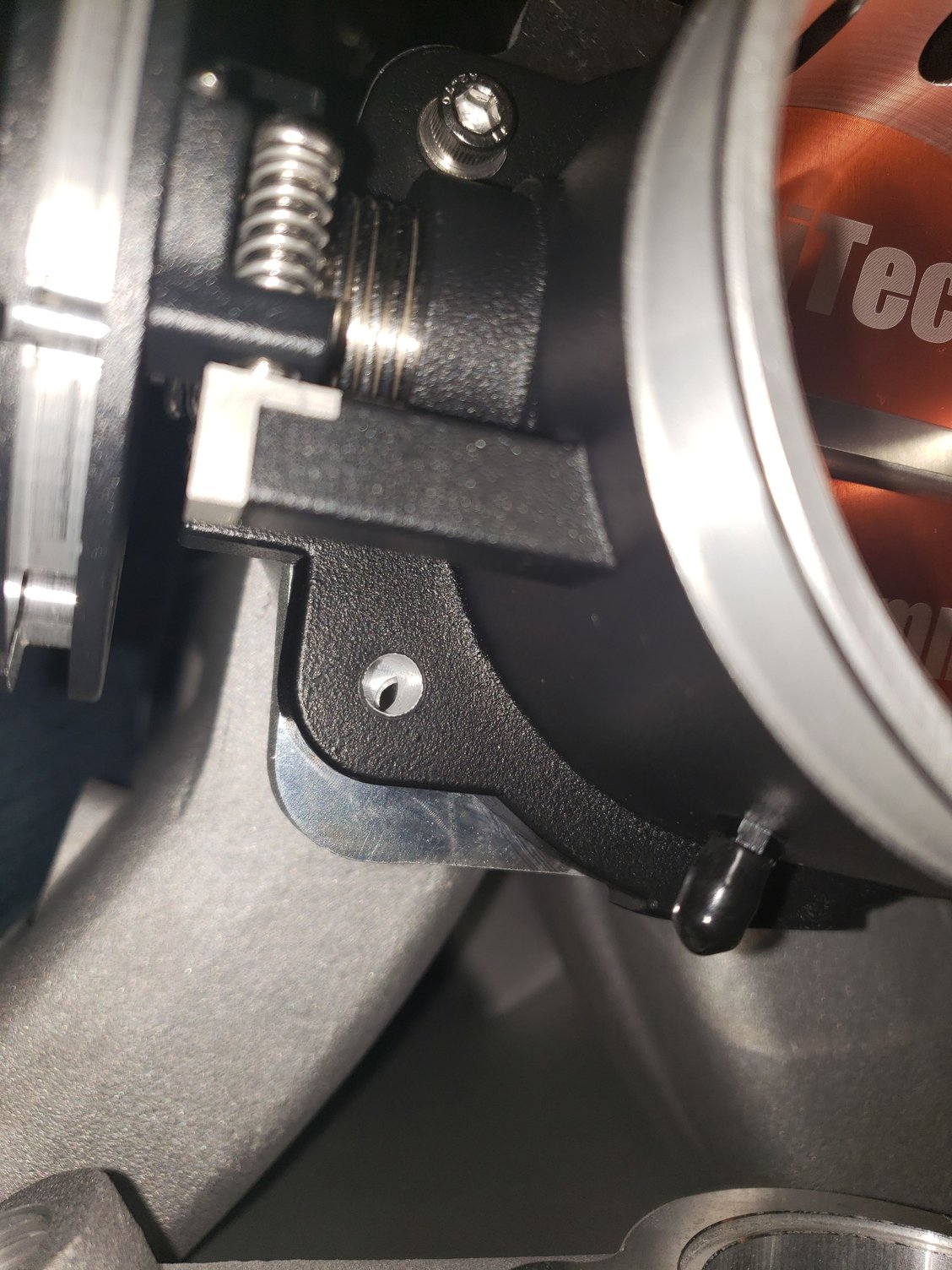

Well one more change on this engine. Most likely swapping the intake manifold and throttle body. Its a clone of an Edelbrock 7137 that actually looks like it may be a cleaner casting. With the manifold and fuel rails at $368 shipped to my door was worth a gamble. A little port match to the intake manifold face and it should outperform the vortec truck manifold.

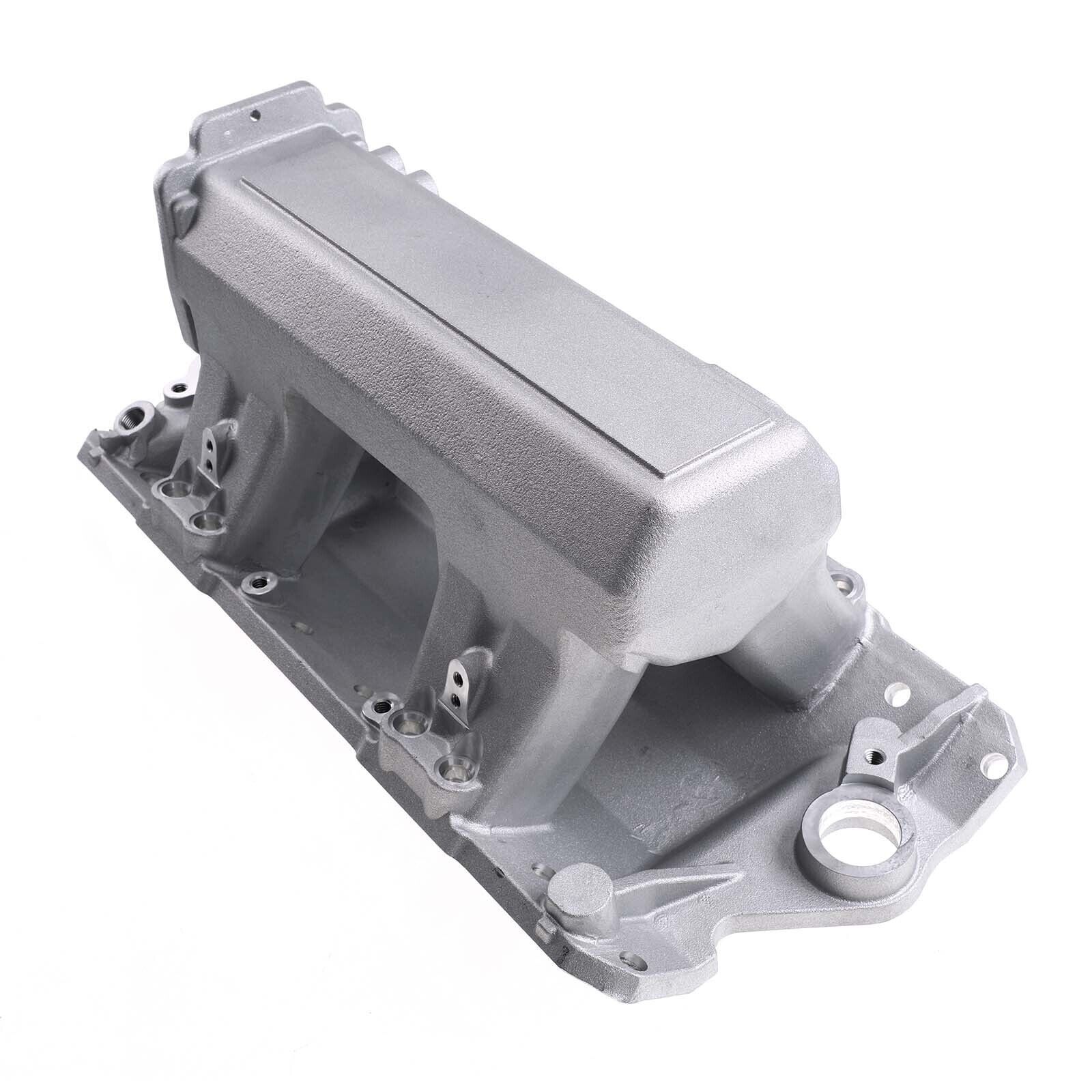

Axle/Gears: 10 Bolt 2.73 Open
Re: Building a Healthy Gen1 383
Interesting. China intake?
Did you ever try the plenum spacer they sell for the truck intake? Or know anyone who has?
I know of a few people that tested the manifold spacer. They made one for the marine intake as well. I had one, no way to fit it without a ~2" body lift. The one tested on a 383 with a ported truck intake did gain power nearly everywhere. Guy went by Vortec Stroker. Had something like 380 wheel hp.
There is not enough room to get a cut down 3.5" Cobra head intake duct on top of the throttle body much less an intake spacer. Getting more air into the throttle body would do more for me than an intake plenum spacer.

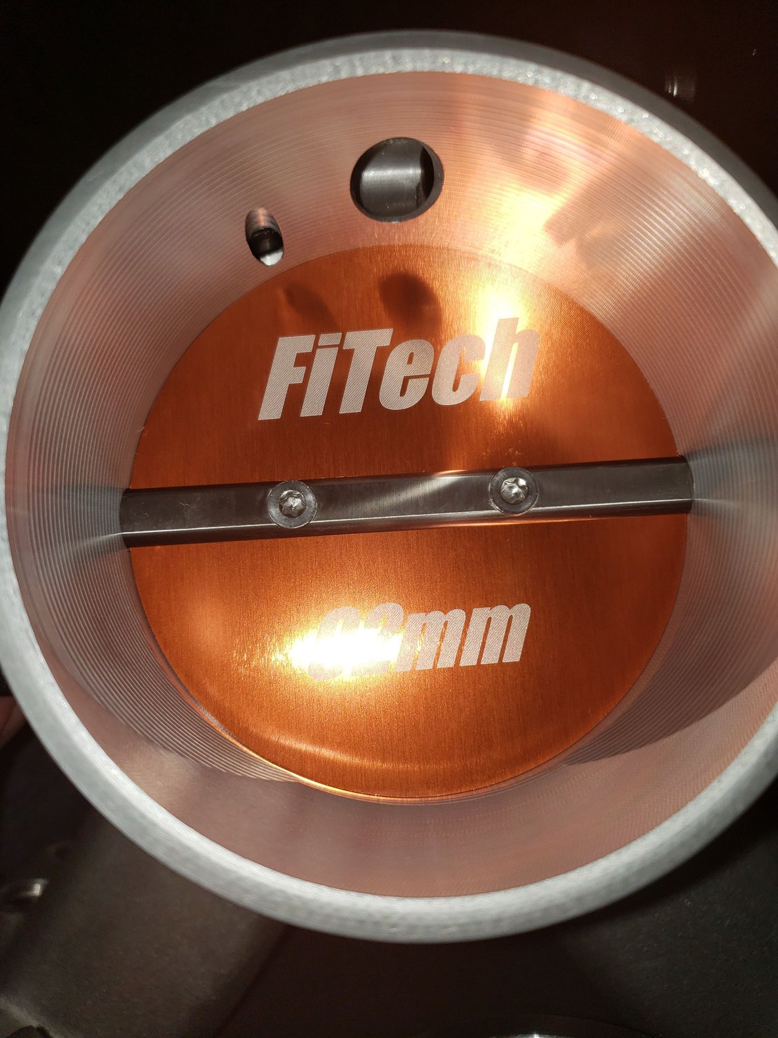

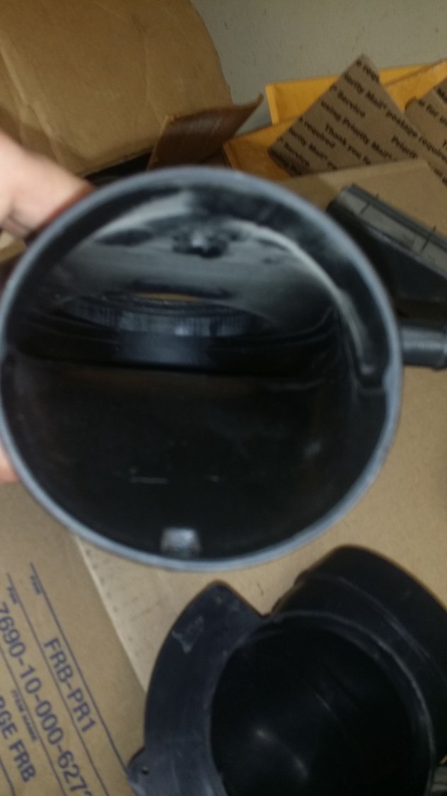

In speed density, I put this guy on top of the throttle body and gained probably 40-50 hp compared to the stock GM air inlet elbow. Not something that could be used long term though as it lacks almost all dust filtration but for a short term test it protected the engine from large debris.. With the stock air hat in place I was pulling down to 88 KPA on a 99 KPA baro reading. With the L31 350 Mag MPI marine flame arrestor it only drops to 97 KPA. 88 KPA is the equivalent of being at 4,000 ft elevation. I am at about 800 ft where I tested it. Average engine loses 3% power for every 1,000 ft elevation increase. 9% of 500 is 45.

It is a china intake fwiw.

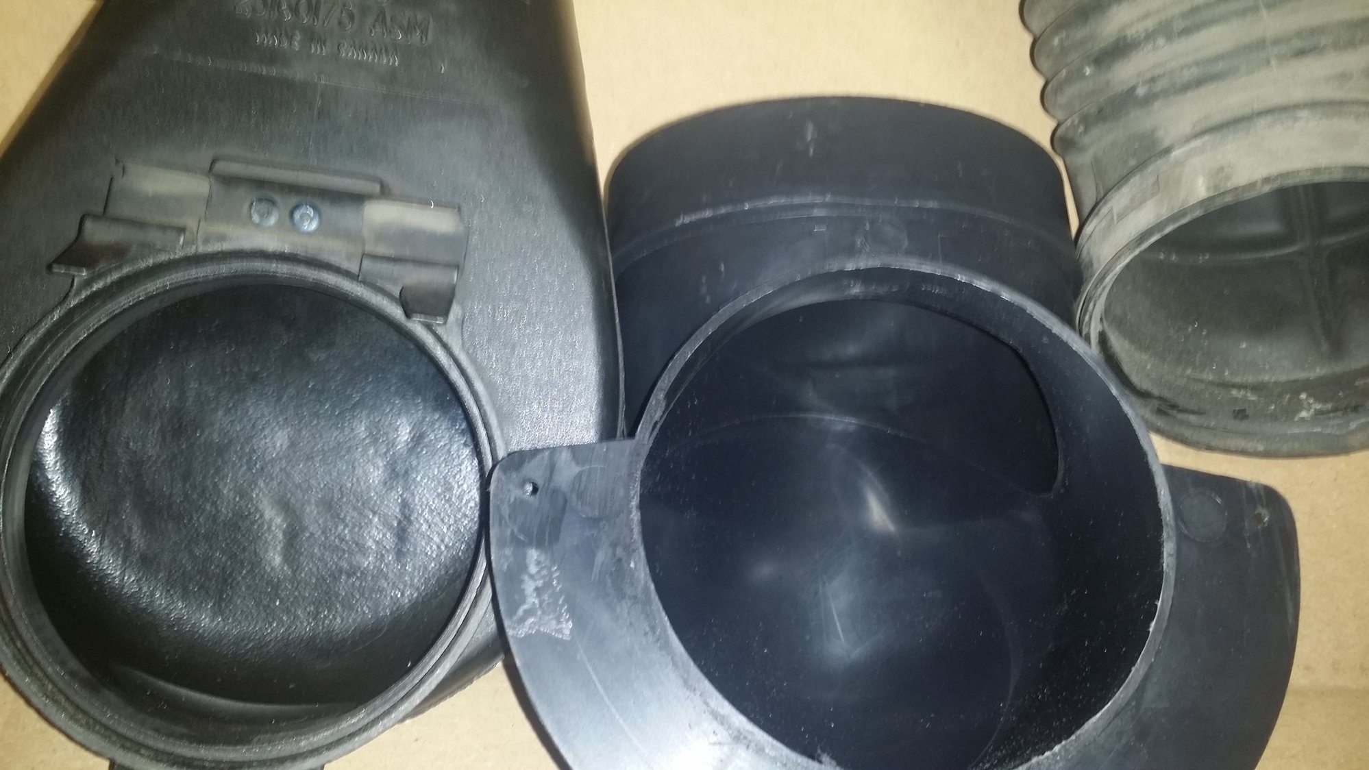

When I had the dual plane marine intake, the 1,000 cfm 4bbl throttle body and the much freer flowing spectre 4" plenum on top along with the slightly hotter Bootlegger cam this engine was using 550 hp worth of fuel. When I swapped the cam and intake I was feeding 490-500 hp worth to it. It appears most of the power lost is because of the air inlet elbow off the throttle body. The air cannot make that sharp 90* turn into the throttle body. I am reasonably certain that adapter alone is why the 305 and 350 are both rated 10 hp less in a van than a truck.
I even tried to get a stud width 4" dryer elbow in between the throttle body and the body and it is too thick to fit into place. The internal cross section of that low profile 4" dryer duct is 3x what the stock elbow is. It's amazing the stock inlet elbow moves enough air for 300 hp much less 500. This scenario makes me laugh every time someone claims a larger streamlined CAI will not make power on any engine setup. It also reminds me of the stock throttle body is good for all the HP guys. The Ramjet 502 came with the TPI 46mm throttle body. A 58mm throttle body adds 50 hp on that engine. The MAP sensor does not lie! When the MAP starts dropping at WOT the engine is losing power.

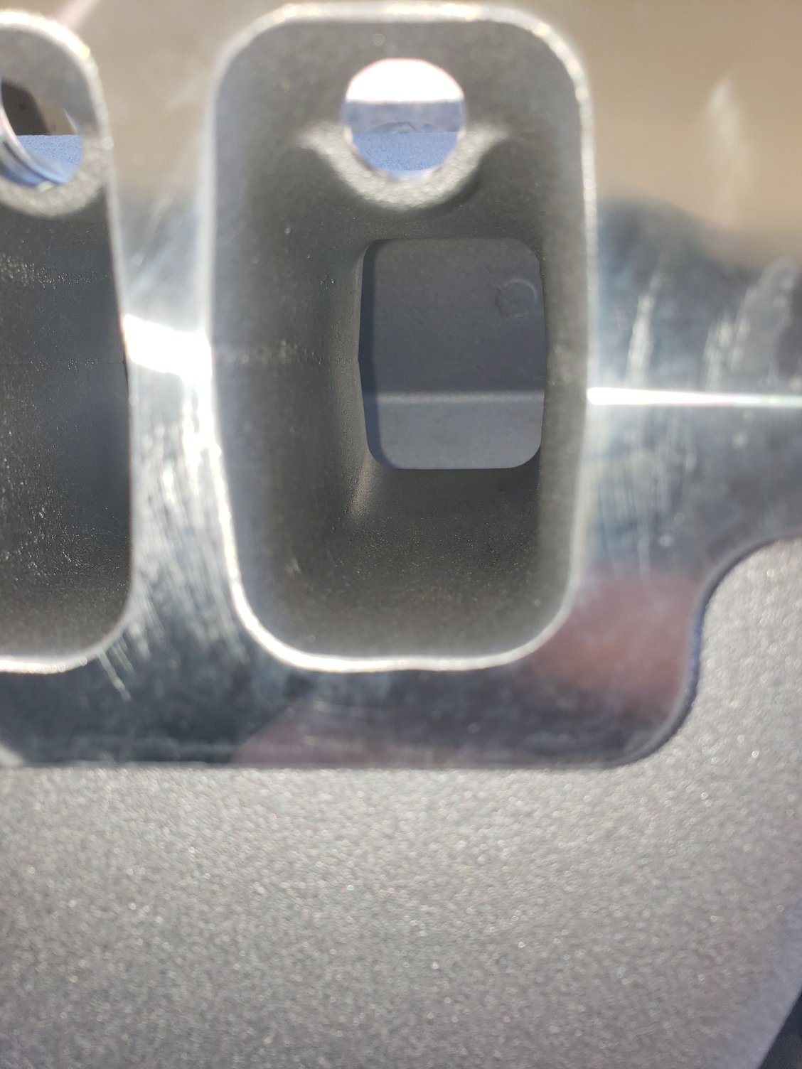

Got the knock off 3717 today. Casting quality is very good. I will do a little port matching and sanding roll cleanup and call it good for my sub 6,500 rpm 383.
Good? That's amazing!
Edelbrock wishes they could make castings that clean.
China wins again.
If the machining is accurate, you're golden.
China wins again.
With any luck.
One thing they should have done is realized that the 4-bolt pattern on that intake is propriatery to Edelbrock and only matches their $700 throttle body. I had my fingers crossed it had the standard 4-bolt LS pattern. I will be having to lightly dremel the bolt holes in my 92mm FiTech throttle body. The manifold looks like I can open up the inlet to match the 92mm FiTech no problem. Edelbrock makes a plate to mount a 78mm LS throttle body but I do not want to choke a 4" air intake system down to a 78mm throttle body. I will be having to grind the bottom of the throttle body where FiTech bumoed it out and stamped Fi-Tech as well as some off the lower side of the throttle body flange. The flange is far larger then the throttle body sealing surface and I want to get a TBI Caprice water neck under it to be able to keep my stock upper hose design and routing. It needs 1/8" off it to clear.

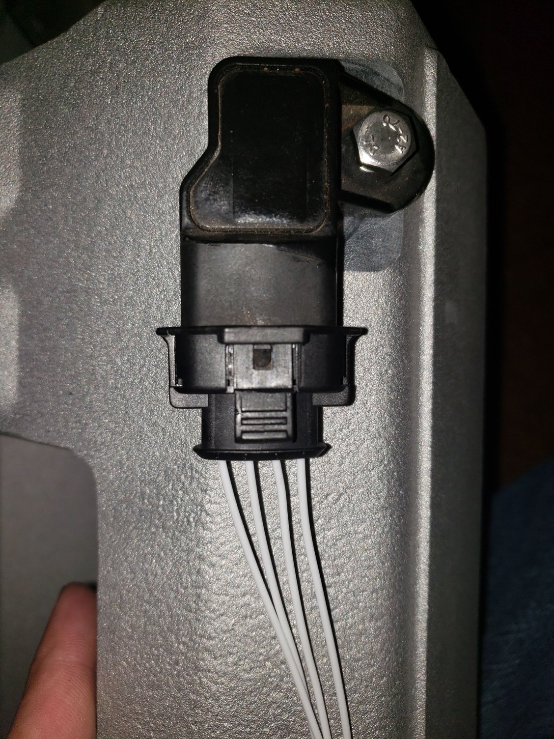

The L31 Marine T-Map is a perfect fit and has the same signal as a standard GM 1-bar MAP as well as the standard CTS/IAT resistance curve.
Then I have the issue of possibly having to build a plate steel bracket to shift my ac comoressor outboard. Just looking at it, the throttle body, especially the TPS and the compressor look like they might try to occupy the same space. No AC is not an option here.
I also need to find a set of stock LS3 injectors.

I thought edelbrock used ford bolt pattern for the tb? Where did you get that intake at?
