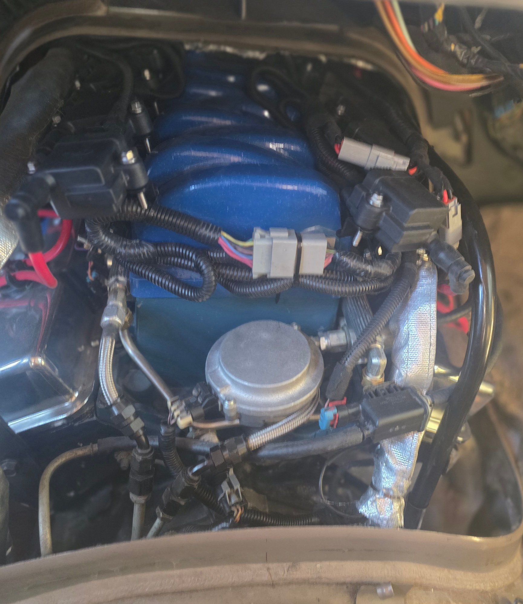

Just an update on this engine. I have upgraded it to 24x ignition, changed the cam to an Erson 219/219 @ 0.050 on a 112 LSA roller and the intake manifold to an Indmar MCX with a drive by wire 90mm LS3 throttle body. It is still alive and kicking, running stronger than ever. There are times I wish it did not have a ~7,000 lbs brick wrapped around it feeding power through a dang 1-ton truck driveline though. It would FLY in a 3,000 lbs car especially with a cam that raised its peak HP up to about 6,200-6,500 rpm. Still only spinning it like 5,600-5,700. It still has more in it off the line even with the 3.73 gear in it but it really needs a locking differential for me to really unleash it as it just spins the right rear effortlessly if I do not use the PE delay and some WOT timing removed under 3,000 rpm.

I am running Mercury Marine IGN-1A coils on it with 0.070" gapped plugs. I have actually had it accidentally as lean as 18.5-19:1 misfire free. Those coils are not joking around, each bank is fed by a 40 amp relay and 40 amp fuse. At full load I am only feeding them about 6 msec dwell where they draw ~10 amps each at 13.3 volts but they are capable of substantially more dwell and spark energy output than I am currently using.

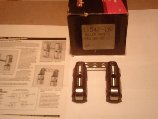

But I have a never used set of old Crane Cams link bar solid roller (Ultra Pro series 11542) - 205g for the pair.
Someday I would like to use them.
11552-16
11552-16
superseded a couple of times 11552-16 11519-16 ?
[img alt="superseded a couple of times
11552-16
11519-16 ?"]https://cimg8.ibsrv.net/gimg/www.thirdgen.org-vbulletin/600x450/crane_soild_roller_lifters_6ce606a477897f86dc005644f74afe5fdccf88e7.jpg[/img]
11552-16
11552-16
Those look nice. I am just not a fan of the link bars on something that is going to run a bunch of street miles. The horizontal link bar looks better in that regard, but I have not used one yet. Some of the horizontal link bar are nice because they use springs under them to push the lifters out of the bores for an easy cam swap without pulling the intake.
