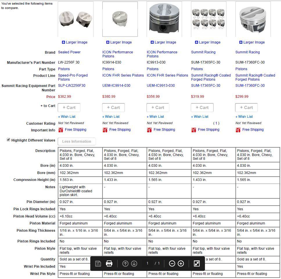

So I met Dyno Don yesterday. Super nice guy and some very cool 3rd gen stuff going on in there. I picked up an 88 L98 B2 (iron heads) from a GTA from him and promptly dropped it off at a machine shop. If it turns out fine, it will be bored 0.030 over and refreshed. As long as I'm doing this, I want to put in forged pistons since I believe they are much tougher than hypers and I may want to add a little NOS in the future. The engine will be otherwise stock (bigger cam) but refreshed.
Don suggested I go with a piston from a 90-91 which bumps the compression ratio from 9.3 to 9.6.
I did some looking around on Summit Racing and found these four that appear to fit the need. I'm looking for affirmation or otherwise!

The link doesn't show any parts. Only a failed "compare" page. (At least at my end that's what's happening...)

Not sure what you had in your "compare", as the link doesn't work.
I suggest strongly NOT trying to buy them as "replacement" for a specific "application", such as you describe. They pretty much DON'T come that way.
Whatever you pick: NOT Speed-Pro. Those are the old TRW line. They are basically replacement truck pistons; heavy, old-style, and they add the .020" of "rebuilder" deck clearance, which you DO NOT UNDER ANY CIRCUMSTANCES want. ACTUAL MEASURED compression height, as opposed to "spec", "designed to fit", "for motors with", etc., should be 1.56", NOT 1.54". Most likely this will mean Wiseco, Ross, JE, SRP, or other similar products. True racing parts, not "replacement". You don't have to go all-out or anything, just, make sure the pistons come up to the top of the deck at TDC. Keith Black & ICON might be suitable choices as well, I don't know for sure.
Don't buy the cheeeeeeepest thing you can find that says "forged" in the ad copy.

Oops sorry about that. I went back and attached the page as a PDF. I took the Speed Pro's out.

Two of your selections have compression heights of 1.433". For a 6" rod.

And the 3rd selection has thinner rings. I have been told to avoid the thinner rings on a typical street build. I was told the thicker rings promote sealing with more drag. I'm not saying that's the bold truth. Just what I have been told. Others with more build experience may have more input on that.

aliceempire, I think the third choice Icons are the same ones in your link. And 5/64 is thicker than 1/16 (by another 1/64) so I'm guess that's actually a good thing?
And skinny z so I need to stick with the 1.565 compression height?

If you're using a stock length 5.7" rod, yes.

So I swung into the shop today and he had taken the heads off and cleaned up the parts. He said it all looked good so far but recommended a .02 or .03 bore and hone. He showed me some streaks along the side of a couple bores. Even though it felt smooth, he said that happens when the piston gets too hot and are probably hard spots. He said if it's round, I don't have to bore, but he said as long as its opened up, might as well. He also said he could use a deck block but in his experience, for this build, he doesn't think it is necessary. He said these blocks are pretty stout. So I'm thinking hyper pistons might be just fine. I'm looking at the two options below.
Hyper Summit's
https://www.summitracing.com/parts/s...c-30?rrec=true (+6cc)
forged Icons:
https://www.summitracing.com/parts/u...make/chevrolet (+6.4cc)
As mentioned, I may want to put a 150 wet-shot on this motor. But no more than that.
Summit Rings:
https://www.summitracing.com/parts/s...9-30/overview/
or Plasma-Moly coat for twice the bucks:
https://www.summitracing.com/parts/s...3130/overview/

So it sounds like if I'm going to have it bored and honed at all, use a bore plate. He has one and can use it. Otherwise, if everything is round, just re-ring it?
And how about these Wisecos? They are +7cc. Won't that lower my compression ratio?
https://www.summitracing.com/parts/w...03a3/overview/
Your CR will drop by about a 1/4 point when compared to a 5cc piston.

Cool. 1/4 point for 2cc's? What are the stock pistons? I was advised to try to bring it to 9.6:1 like the 1991 5.7s Maybe I can go a little higher than that just because? 10:1? 10.5:1?
Found this thread. It's got a lot of good info.
https://www.thirdgen.org/forums/tech...-question.html
So by my reckoning, the thread says factory pistons are +12cc, so if these are +7cc then I lose 5cc with these Wiseco pistons and gain 0.25 CR for every two cc or 0.125 CR for each cc . And 0.125/cc x 5cc = +0.6 CR for 9.3 + 0.6 = 9.9 CR ?
