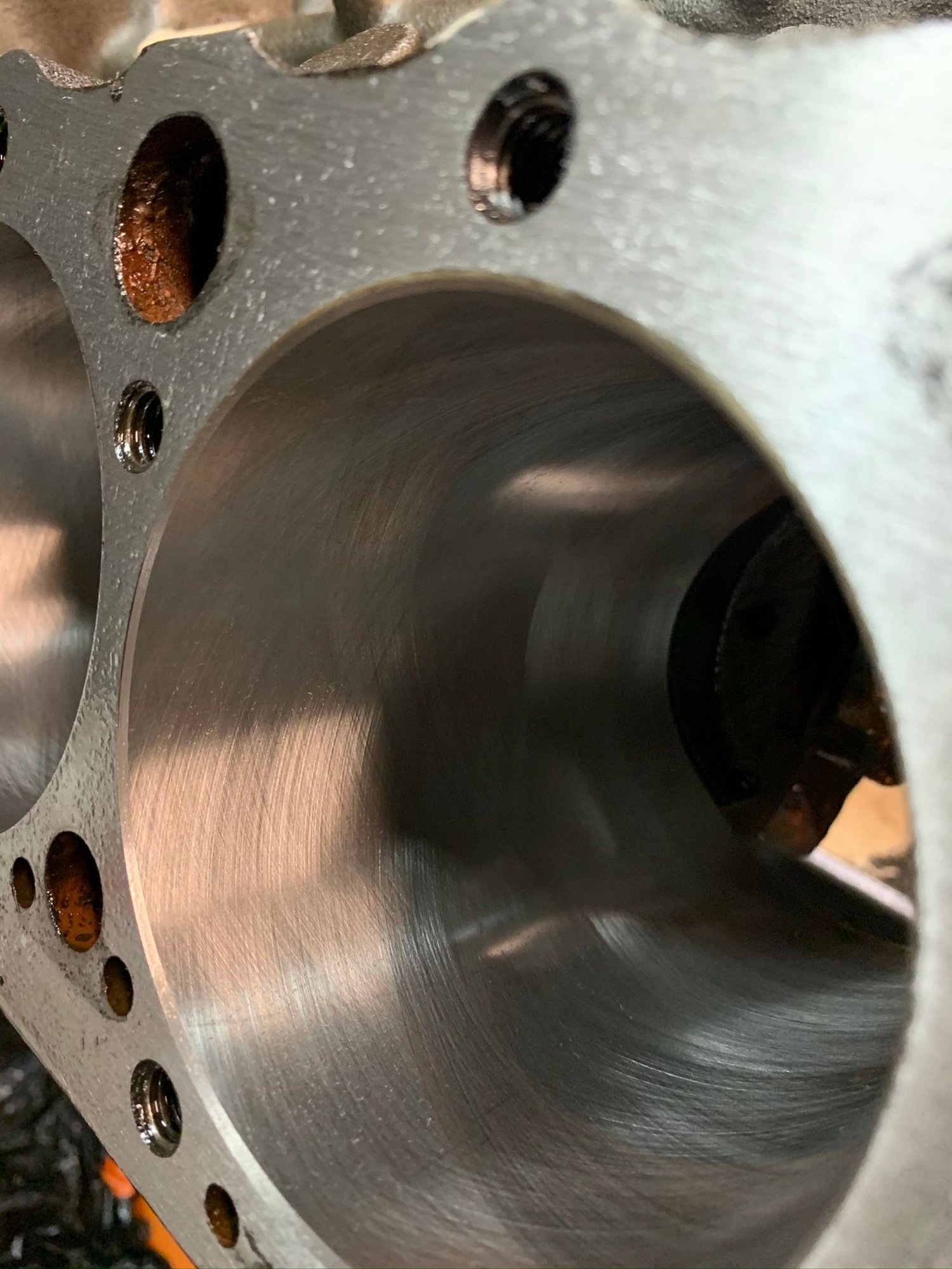

Thanks for all the help on the sight here! The short block is well underway. The crank, cam and first two pistons are in. I measured and all clearances are within new specs.

Is that grease, or assembly lube?

Redline assembly lube https://www.summitracing.com/parts/red-80319

What did they use to square deck with looks odd..................
Old Oct 20, 2019 | 09:20 PM
GeneralDisorder's Avatar
Joined: Mar 2017
Posts: 4,255
Likes: 427
From: Portland, OR
Re: L98 Rebuild Pics
That doesn't look like it was squared..... doesn't even look machined.
Belt sander?!?
Yeah that's a pretty weird (sh1tty) deck finish if you ask me. Definitely don't use an MLS gasket on that mess. Should look like this:
