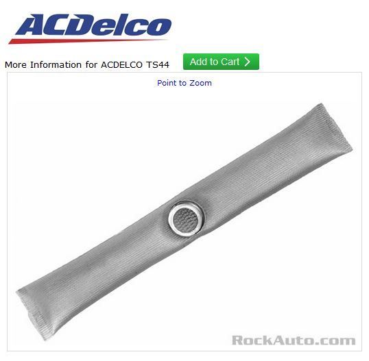

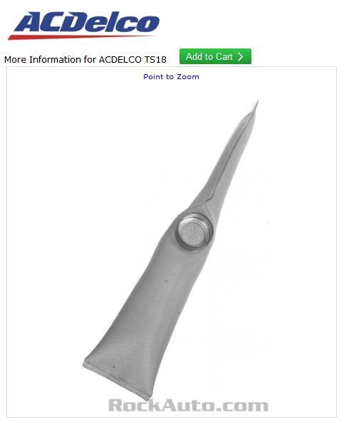

You want the Delco or Delphi strainer that's twice as long. AKA the 1LE strainer. It was standard on all later thirdgens, but most of the generics are the shorter early version.
TS18 is the original style. TS44 is the 4th gen part that is functionally the same and generally is listed as the modern replacement. Any of the shorter strainers will technically function, but they're a downgrade from the original.

AC Delco TS18 9 x 2 x 2 inches
AC Delco TS44 9 x 2 x 2 inches
Delphi FS0177 8 x 1.6 x 1.6 inches
