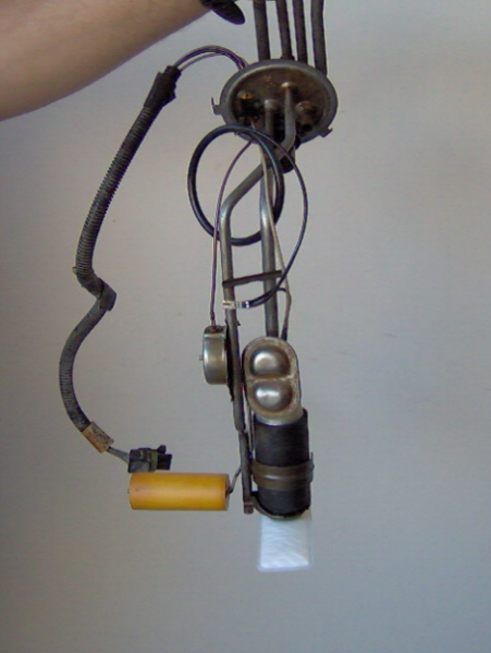

After you have disconnected the harness behind the backseat and infront of the gas tank. Dont worry about pulling the fuse because this has to be disconnected anyways.
I cut the lines using a Makita Sawzall. As i was cutting it i had a shop vac right next to the blade to suck any shavings or other stuff including sparks, dust and dirt. I stuffed a rag around the lines to catch any fuel but none really came out. Just take your time and cut slow. Its not hard but you dont want to cut the tank.
You could do this before you remove the lock ring but you might end up twisting the pump assembly at the same time.

When pulling the pump assembly out you will probally have to 1) pull straight up 2) then tilt towards passenger side 3) then lift up sideways and the float and strainer will be at the top. You will have to work with the strainer and float to get it out of the hole. The strainer will bend at the ends so you can pull it through the hole. Once out youll have the whole assembly. Fuel will spill out.

You now can disassemble the pump from the assembly. Youll have to remove the strainer from the bottom. Just pull straight down. Its kinda tuff but itll come off. You can now slide the pump up some and remove the black thingy off the bottom of the pump and then slide the pump back down and off. Remove the BIG o-ring if you want. Remove the black sleeving around the pump if you want. the new pump should come with them (2) parts new. I just used the old ones.

Axle/Gears: 4.10
Sorry it took so long to get back but i finally got the plate on now.
The HP hose have held up so well with no leaks or fumes i decided to just leave them be.
The plate i used is from Home Depot. Its a 28"x16" sheet metal that i cut down to size of 13"x 8". That gives me about 3/4" around the outer edge of the hole. I used a silicone type silly putty to seal it up. I didnt have my camera and it was a spur of the moment thing so i dont have any progress pics but i do have the finished product.
I wasnt real enthused with the outcome but it did turn out nice. I originally wanted to sand the plate and paint it black that way you could see the aluminum rivets. But like i said it was a spur of the moment thing.

And here is a close-up

Since i have some tools at my apartment, im going to try and sand it real good and them polish it. I had my buffing wheel (fits a drill) in my car and i buffed it alittle with some mothers and it really shined. So i might give it a try.

Originally posted by Bri3212.Sorry it took so long to get back but i finally got the plate on now.
Finally, Jeeez, been waiting for you to finish this freaking thing up for well over a month now! j/k
I'm honestly a little nervous that you chose to stick with the HP hose, but if you've been monitoring it, and it's been holding strong.... <fingers crossed>
Excellent work on the fabrication!

So are you going to have to drill out the rivets every time you want the access door off?
It's a lot safer than having 20 pointy screws a quarter-inch from your gas tank.

very nicely done i must say. i did almost the same thing as you did. but i built the access door on a hinge. i then drilled holes and ran bolts upward and put holes in the access door. and used nuts to secure it down. i used old weather stripping fron a deck lid to secure the fit. i was going to use rivits but then i thought what if this new pump goes bad in 2 moths like this one did. and this way its easy to check the hoses every now n then. first time i changed the pump i did it the correct way and thats when i saw that the car had been cut. me personally i wouldnt have cut it but since it was already done i decided to make it at least look decent.
i think this is an awesome thread explaining how and why you did it and that nobody came in flaming. sometime you guys are decent

Originally posted by TA
Nicely done so far. I agree that I'm a little apprehensive about the long term reliablity of the hose-clamp/rubber hose connections. It would probably be fine, but I think you'd be on the right track with the compression fittings instead.
Another idea is to use sections of socketless hose from Aeroquip. There is always the use of AN fittings (my favorite over compression). You pay a little now but they are a lot less prone to leaking.
As for an access cover, I would use POR-15 around the access point after I sanded it down smoothe and removed any burrs. Rust is the enemy, followed by moisture and noise.
Depending on how often you want to get into the access point, you could use the POR-15, a slightly oversized cover, and a couple screws and call it a day. Paint the panel with POR-15 and then attatch it to the car while it is still tacky. Use the screws for back up and the POR-15 as a kind of adhesive/gasket. Its thick, kinda like epoxy and with the properties of an all pupose sealant.
Pricey option: Use a thick piece of continuous aluminum to go around the access point. Use very small carriage bolts to anchor the panel to the car with a relief to allow the nuts to sit under the plane of the top of the surrounding aluminum. Then, use machine screws and tapped threads in the surround to anchor the cover plate down.
I really agree with the access hole concept. It is a PITA to drop the tank for what could be a 20 minute repair. Are you violating the sanctity of the unibody? Yes. Are you makiing less a less traumatic situation for any future repairs to the tank? Yes. It is up to the guy who does this. Do it right and it is a great help. Do it "billy-bob" and no one will ever appreciate it no matter how practical.
The rivets add a nice touch! Looks good as-is.

I used some weather stripping that come from a body shop. They use it for sunroofs so i figured it would be fine for this.
Theres alot of things that i would have like to do but it cost money. I did this for
(free) Fuel Pump -warranty
$6-hoses and clamps
$4-sheetmetal
$1-rivets
$2-weatherstripping
$13 total.
The weatherstripping & rivets was provided anyways from the guy who helped me.
I can always go back though.
