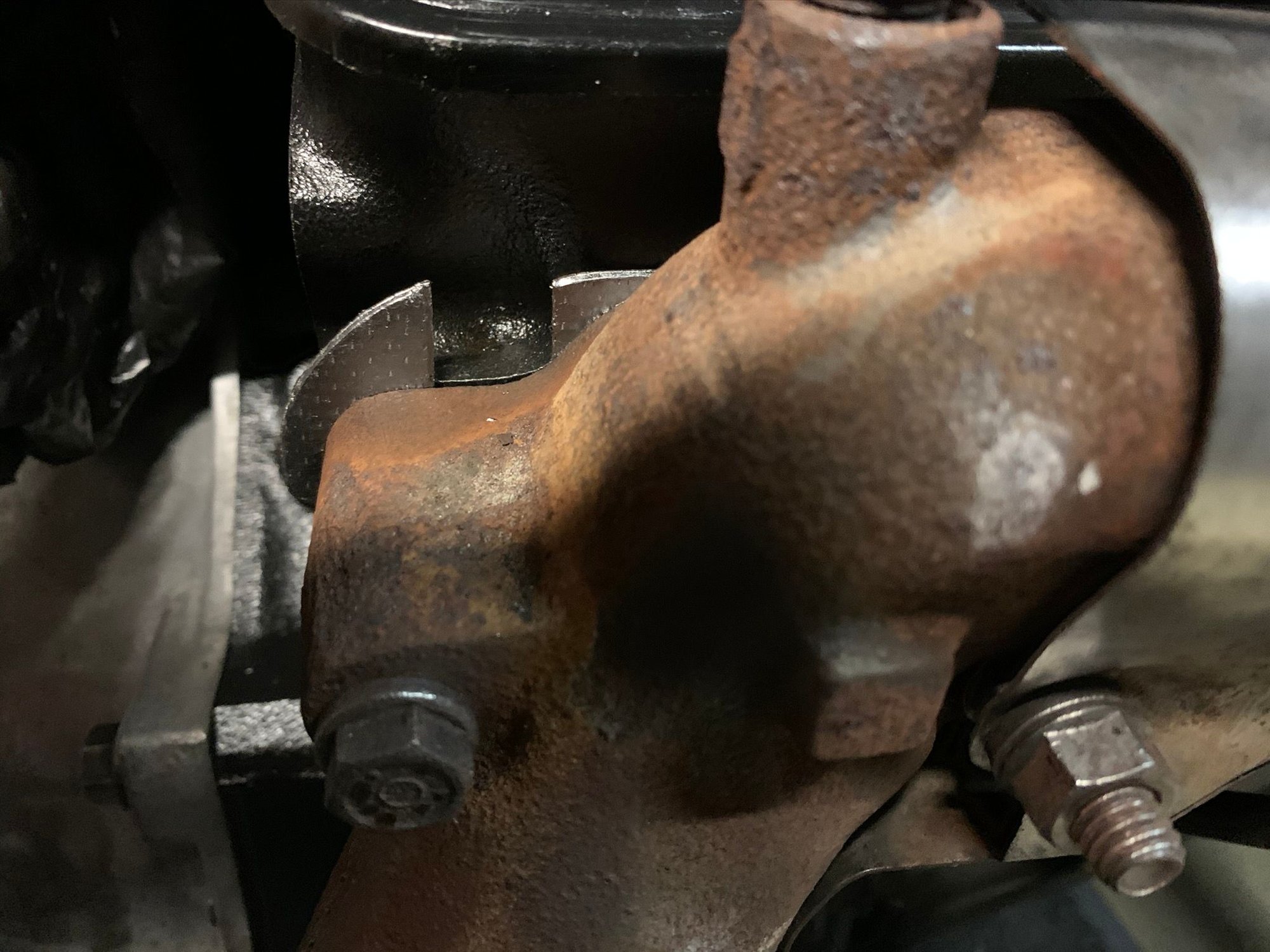

1. The exhaust manifold gaskets in the kit were identical but one was too short on the back bolt hole passenger side as the exhaust manifolds have a slightly different bolt pattern of one bolt (rear pass bolt). I just snipped the gasket end off and used it around the other end of the last bolt so that the manifold clamped down evenly. The ports are identical as are the rest of the bolt locations. Any issue with this creative gasket cutting?

Have you ever seen an original thirdgen with exhaust gaskets? Throw that **** away.

Remflex for exhaust gaskets.

Huh. Now that I think about it, you are right, there were no gaskets on my LB9. Huh. Ok then I'll just remove them. Do I need the factory lock nut tabs? I saved those also but figured I don't need them.
