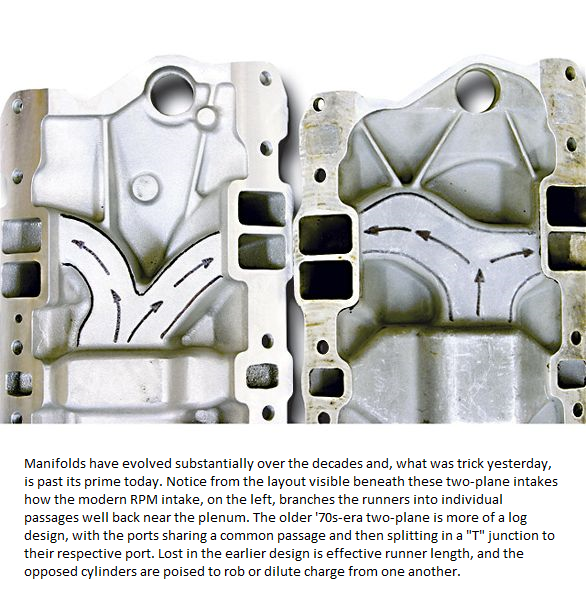

Most likely, you wouldn't feel any difference, except for your lighter wallet.
The design of the dual-plane intakes has changed over the years.
So you might see some small increase if you were to use a "modern" designed dual-plane intake like the Performer EPS.

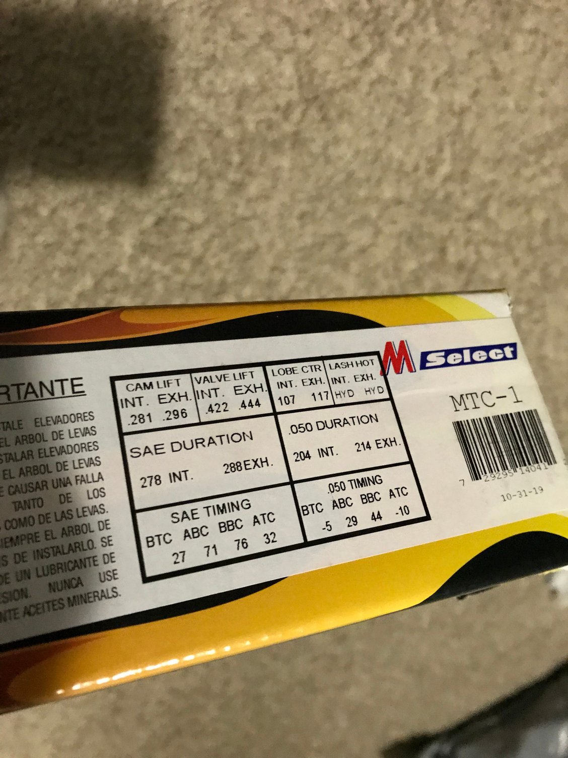

unfortunately I bought the cam and installed it already here are the specs. It’s not too far off from the numbers you gave and it was recommended to me by somebody who owned multiple third gens.

Old Feb 23, 2020 | 04:24 PM

I would rethink the RV cam. Go with somethibg more like 218/218 @ 0.050. 305s love single pattern cams on a tighter LSA.
What would that cam pull for idle vacuum?

cam is the proverbial rv type its ok....eliminating the egr gains you nothing. Those do NOT make your engine ping thats a wives tale
ok thanks for the info, I’ll leave it then! I’m not one of those people who just wants to rip off all the emissions parts just for the sake of doing it lmao. If it helps clean the environment slightly, so be it lol

Proper maintenance and tuning does more for emissions than emissions equipment does. My old 1995 Firehawk proved that fact to me. Put it on the emissions dyno at work (this was years ago) no cats, no air pump, no egr, all tuned out and tuned for power while otherwise largely stock and passed the sniffer without issue. All 3 checked gasses, NOx, hydrocarbons and CO, were easily under the maximum limits. If that stuff even works on your car anymore, they’re a bandaid to cover the compromise OE’s have to make to between emissions and fuel economy. The two don’t often play nice with one another.
