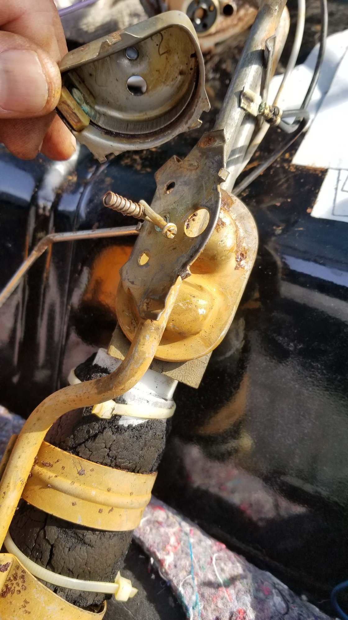

I just took my sender apart, and was wondering if anyone knows if it is missing anything. I can make it work by touching the pin to the resistance wire, but when its together it doesn't work. It looks to me like something is missing where the contact happens. Any ideas?

Any ideas?
Yes.
Replace the entire assembly rather than trying to 'repair' it. And while you're in there, replace the fuel pump and all it's associated plumbing as well.
Buy top-quality parts for the job; considering the difficulty involved in getting to them, this is not the time to rely on cheap ebay Chinese crap.
Good luck.

I agree with ironwill on his first statement , repair isn't an option , replace the whole shooting match , sender , pump , sock , oh what the Hell might as well hit the fuel filter too .....

Well I repaired it. I used braiding from a slot car and tie wrapped it around the pin. Worked like a charm.
I'll replace the whole thing sooner than later but now I have to figure out where my spark went...

I take it that you have the good ol famous access panel in the rear too..
Old Feb 24, 2020 | 05:55 PM
dexxy's Avatar
Joined: Feb 2020
Posts: 13
Re: Can I fix this fuel sender?
yup the guy who owned it before me had made the panel so i was able to pull everything out to test.
