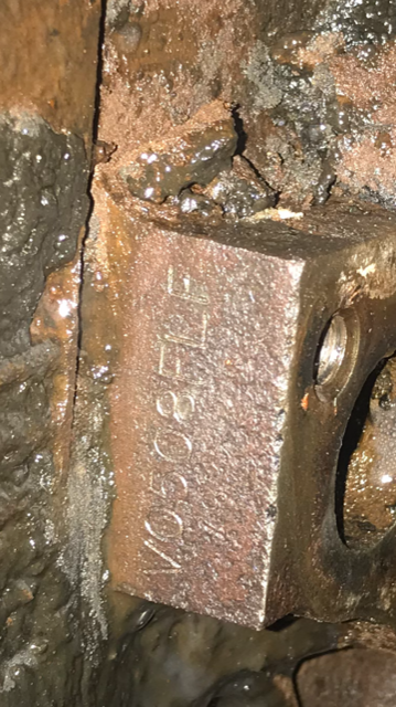

Hi Everyone,
New here and just wanted to see if anyone has insight on my casting numbers
Casting# passenger side above water pump connection V0508FLF
Casting# on drivers side behind head 14010207
My confusion is more about the FLF designation.. cant find much about it

I found reference to another FLF coded engine, with a partial VIN from a Chevy truck. The block casting is 1980-1985 350.
Looks like there may be a partial VIN below your code stamp in your picture but I can't read it. I see what looks to be a "1" on there. See if you can find the rest of the numbers there.

That seems to check out on Nastyz28.com. It also says on there it has 4 bolt mains, and came from Flint engine. Tomorrow is its 35-40th birthday, it's not too late to buy it something nice!
Who knows on the year, I was up and down the list on 1968ss.com with no luck. I was even looking at other codes that could look like FLF if they weren't stamped correctly to no avail.

That is one crusty-looking block. It's prob a generic 350 truck motor, mid-'80s. I'm assuming you're planning to completely rebuild it; have the machine shop check it for cracks before you put any $$$ into it.
