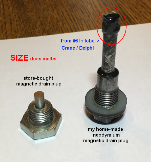

I am concerned about the old worn out Crane cam. The shrapnel from the worn lobe(s) is continually circulating around inside your crankcase if you haven't taken steps to clean it ALL out of there.

A good point. We did standard cam break in procedure with Lucas break-in oil when swapping so I’m sure the successive oil/filter changes would’ve helped clear a bit of it out, but what would you advise for helping clear any lingerers?
I you or nobody else actually took the engine apart and completely cleaned that out of there, changed the bearings and oil pump, flushed the oil galleries, etc - then those shavings are still there and WILL cause further damage. Ask me how I know.
A magnetic oil drain plug couldn't hurt.

I am talking about what happened to the metal shavings from the old Crane cam/lifters?

I won't even tell you what happens to your cylinder walls. There is a slight chance that you might be OK, though.

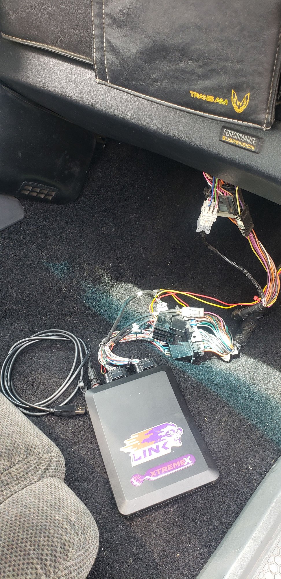

Alright here’s an update on what I’m dealing with:
After lots of tuning and the discussions we’ve had on here, I finally resigned myself to idling at 1200 in park and 800 in gear, tried it a bunch of times and it was solid, and honestly I was quite pleased with tuning it down 100 rpm from where it was... so I shut her off and started putting some stuff in the trunk.
Came back, without changing a thing. Fire her up, shift her into gear—dies. Raise the idle to 1300, dies, 1400, dies, 1500, dies. Somehow, in the 5 minutes since I walked away without changing a thing, the problem has exacerbated to worse than ever before, needing a 1600 idle to shift without dying!
I’m at my wits end! What do I try next?
