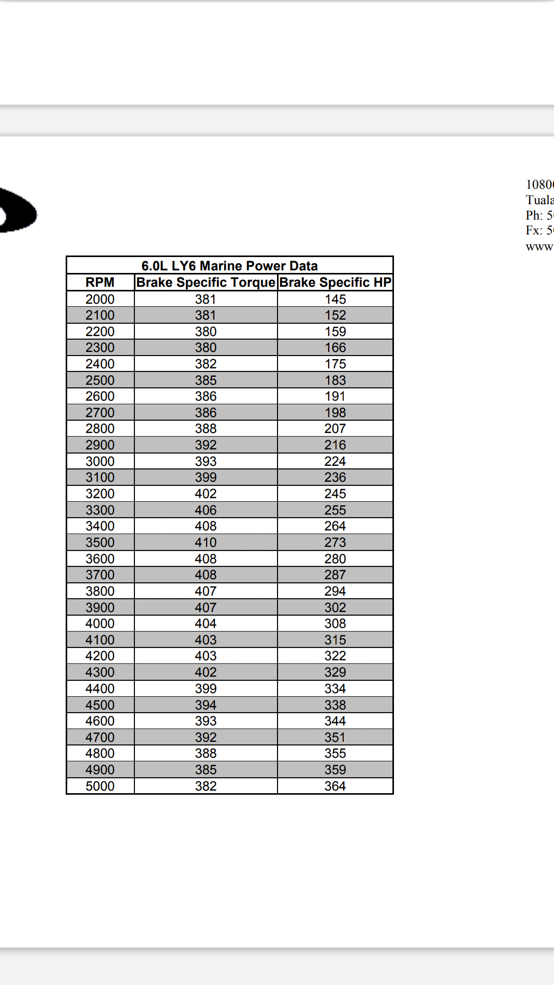

Unless you are trying to build low-end torque. A 5.7 Vortec puts down more torque than a LY6 6.0L with VVT under about 4,000 rpm. Comparing the dyno chart of two Kodiak marine engines head to head. Then again a set of stock 862 5.3 heads ported and cut for a 2.00" intake valve on a LY6 with VVT would probably exceed the torque of a Vortec 5.7L but require premium fuel to do it.
I studied lots of LS builds and small block builds before deciding to build the 383. At the time I had the heads for the 383 built they were going on a 4.125" bore.
what dyno test was that? Seems surprising but the ly6 wasnt as strong as the 6.2 that replaced it with the same heads. The slighly bigger bore and newer truck manifold really helped that setup breathe And made awesome power.
I couldn’t keep mine from downshifting below 4200 but it was already making 368 lbft stock there and had way more below that rpm i could tell. It was stock 6.2 truck with just a tune
So I was off a little, looking back. I last looked at this info more than a year ago. 350 was stronger under 3,000 rpm, not to 4,000 but given that it has a shorter stroke and less displacement and lacks VVT that is still impressive. The 350 is also making its grunt with a shorter runner intake, stock Vortec heads and a 196/206 @ 0.050 cam.
I also looked at the direct injected 5.3 and 6.2 as a possible replacement for the 350. In the end I built the 383 because it is capable of more torque than even the DI 6.2L down lower in the RPM curve. The more torque I make in the 2,500-3,000 rpm range the less I have to downshift pulling a trailer. If I had more budget to my build it would have been a 4.125" bore Dart SHP block and 414 cubes. In all honesty that 414 may come later. I like torque. The 383 in the head comparison above is killing a LY6 in power and torque. If the 350 Vortec had been treated to some Etec170s and a set of 1.7 rocker arms or a small cam upgrade, it would probably equal the LY6 in power without hurting the torque production.

Originally Posted by Fast355
dyno sheets
See, for me, that tiny 7lb/ft deficit is well worth the gains the LY6 had from 3500-5000.
That was a stock 300 hp 350 compared to a LY6. Basically no gains from having a LY6 in the RPm range I wanted to run in. Now look at the 383 in the head comparison above. Very typical to make 480+ TQ from a 383.
