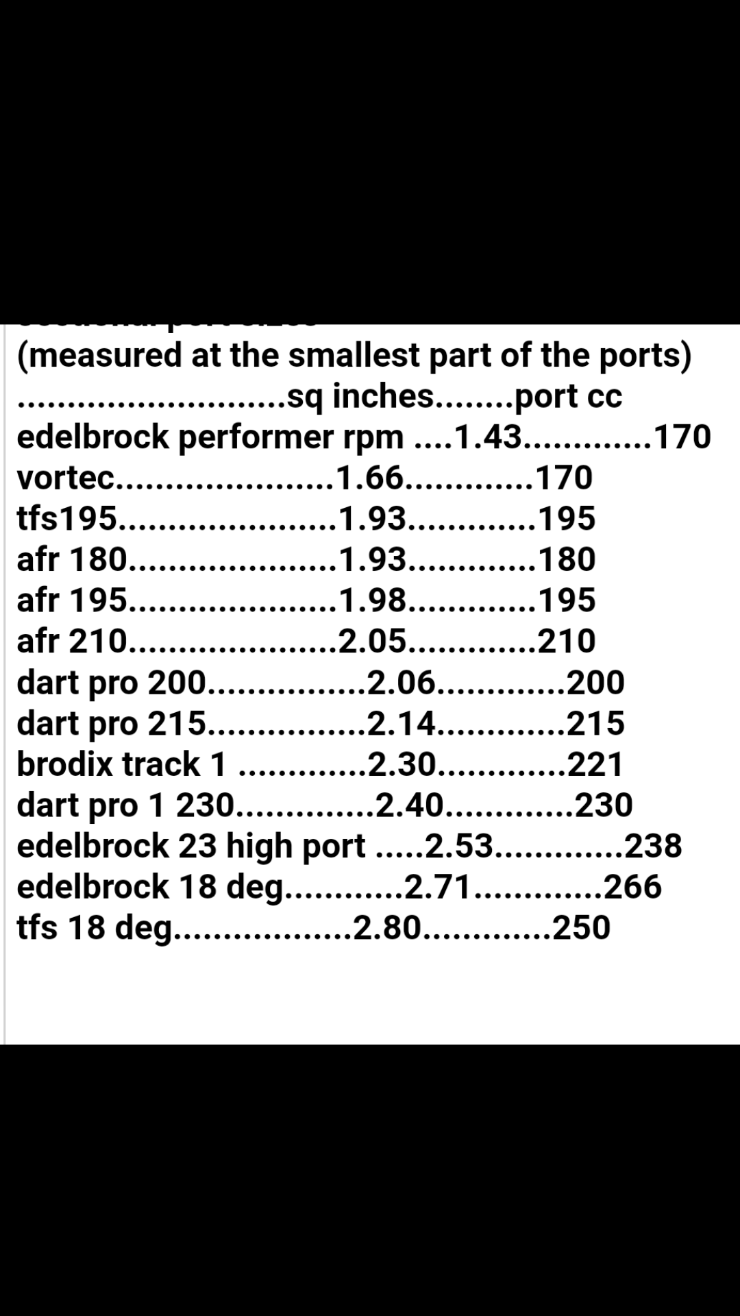

I think 180cc is perfect for a cam that size. 195 may cost you some port velocity at the low to mid rpm ranges.
But trust me, the 180s do extremely well high rpm. I'm running AFR 180 with a 212 cam and am amazed at how hard it pulls up to 6000 rpm. Mind you I'm runnkng a miniram so the short runners probably help. But I still get the ridiculous amount of torque at low to mid range as well that you'd expect with a smaller cam.
Youll like that cam too... idles very smooth. I get about 13.5 to 14 inHg vacuum in gear at 650 rpm. I do have a 2500 rpm converter too so it doesn't excessively load the engine at idle.
What I would also recommend highly is to change your axle ratio out to 3.42​​. Thatll probably the biggest bang for the buck out of any thing.

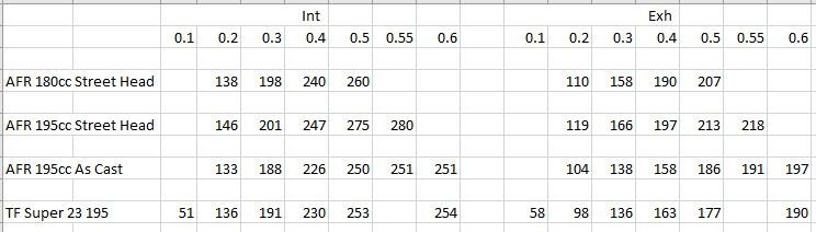

Seems a lot of talk regarding port volume vs flow.
Here's a chart I quickly put together.
Based on the above comment, which would you pick?
Note that AFR tests with a 4.06" fixture bore vs Trick Flow's 4.03". That might amount to a 2% difference (based on some back to back bench tests by Chad Speier). And AFR doesn't publish below .200".

The flow between the TFS as-cast and the AFR as-cast is close enough that it's going to come down to price and fitment with the headers. $477 vs. $635......
The AFR's can be machined for center-bolt and you can have straight or angled plugs.
AFR is square port exhaust, TFS is D port.
AFR uses ARP hardware.... not sure on TFS.

Re: 195cc head too large for mild 355?
Originally Posted by skinny z
Back to the CFM per CC thing, if you're not going for big numbers, then it would seem the 180's will produce possibly the best results. This is to say, they may have the edge over the larger and slower 195's but only up to a point. Then it's airflow all the way. The books say 8000 RPM capable with a 310-320 degree cam in a 350.
I'd pick the AFR 180s over the as-cast 195AFR and TFS no question. However, if you compare the 180 and 195 AFR Eliminators, you can see the CFM/MCSA is about the same. It's also really close comparing CFM/Volume. I also added the target RPM for the MCSA for the 180s and 195s.
Not saying that you can't cam up and go higher, just based on formulas from Vizard that I've been using for years, the target RPMs based on the MCSA seems to have proven fairly accurate based on my experiences. The estimated HP numbers are a combination of my own experiences combined with another formula from Vizard based on airflow. Again, there are a ton of variables that can mean you'll make more or less - if you don't like them, use your own - lol
I see no real advantage that the 180 Eliminators have over the 195 Eliminators. They're nice heads and will make good power, but there's no question they'll have less RPM capability and less HP capability based on MCSA and airflow on both the intake and exhaust side compared to the 195s.

The afr 195’s i thought were closer to 1.95-1.96 csa but they peaked at 6250 on my 383 with the stealth ram runner length and a 230 deg lobe. With some cam duration you can get them to hold out past 6500 a good ways
I got the MCSA for the 180s and 195s off AFR's sight - they may actually measure higher though.
No question the heads can easily peak higher than what I have in the chart. The formula is what I use when I'm trying to figure an optimal MCSA based on cubic inch and a target RPM. I've never been disappointed or made any less power than expected when using it. I backed into it to get the "target" RPM in the chart. Meaning if I were building a 383 and planning on making peak power higher than 5750/5800 RPM, I'd look at a head with a larger minimal cross-sectional area, along with a proportional increase in flow compared to the AFR 195s (not easily found).
Your example as well as a number of 383s with 195 AFR heads have shown proven dyno results making good power at a higher peak RPM than what I have in the chart with moderately sized cams and single plane intakes. So, it's not a limiting or maximum figure in the least.
Edit: Plus the numbers are based on the figures published by AFR. Based on the dyno results it's possible, or likely, the MCSA may be larger and certainly I'd go with proven dyno results over a formula any day of the week and twice on Sunday,

The AFR 195s move more air per CFM (should mean higher velocity) than the TFS 195s, so you would better off spending $450 more for the AFR 195s...
Can you explain that one in more detail? A cubic foot (at STP) is a cubic foot. A minute is a minute, regardless of where on the planet you measure it. Did you mean "CC" instead of "CFM" in that statement?

I think he means cfm per cc as listed in his chart table
fwiw programs like pipemax can help with rough sizing of port areas.
355 can really start using 1.90” sq mcsa around 5600-5800. This is higher than most tpi setups, possibly in range of a first tpi with enough cam, it can help make more top end 5500 to 6000 shift If you cam it right and can run faster if you gear it and converter it right lol
below 5600, afr 180 is recommended for a 355. Since thats not a lot of rpm. Might be ideal if you dont plan on more cam than that or higher rpm intake. If you have siamesed runners i would siamese them as much as possible to gain rpm as thats free hp. First may give you capability to 5800 with that cam. I’d like more cam with first or heavily siamesed tpi. They all will be torquey with tpi though

It would be interesting to see the chart below with an additional column with airflow at maximum lift. Or at a spec lift.

I’ve seen those numbers referenced as far back as 2006 and I don’t think the Eliminators were available until mid-late 2006, early 2007??? Pretty sure the Track 1s have had a revision since then also. So, I’m not so sure those numbers reflect current offerings. Just that the MCSA of the AFR 180 is so much off compared to what AFR has advertised on their site makes me believe those measurements are probably from the older AFR heads.

I wouldn't doubt the chart is outdated. Just something I found while poking around and trying to establish the correlation between MCSA and port flow. While the two are linked, the relationship isn't exactly linear.

If I understand what you’re trying to get at they’re not going to be linear. Some porters and head designs are better than others and will be able to get more flow from a given MCSA than the other. Differences in the valve curtain area comes into play as well.

you basically described my LT1. Gross duration is 282/290, .50" is 231/239 in a 5.7. It does rev to 7k, it revs fast enough in 1st and 2nd gear that you can easily bounce off the 7200rpm limiter. But power plateaus around 6500, and starts falling by 6800rpm.
The AFR 195s really are good enough that I'd skip over the 180's in a 350ci application every day of the week.
That chart is out of date and doesn't match up with the current gen AFR 195s.
With a sane street came like what the OP posted the AFR195's would provide good power everywhere with great top-end.
https://www.airflowresearch.com/195c...cylinder-head/
Code:
Lift .20 .30 .40 .50 .55
Int  146 201 247 275 280
Exh  119 166 197 213 218
Compare that to the 180cc head, which from what I remember still uses the older casting. The 195's really shine over the 180's. Even at low lift #'s.
Code:
Int  138 198 240 260
Exh  110 158 190 207
7000 is a sweet sound that's for sure. Even smallish heads at about 180cc with only 255-260 CFM at peak lift, combined with a 288/294, and the 355 would zing to 7k. Not that it was making any power up there, but still, it prompted me to put the limiter at 6500.
​​​​​​As for the chart being out of date. Which chart? The one with two AFR heads on it? Keep in mind those 195s are the new as cast version. Numbers there are right off the website. The other chart a few posts up is something I lifted off the web while looking for MCSA and CFM. It could well be over 10.years old.
