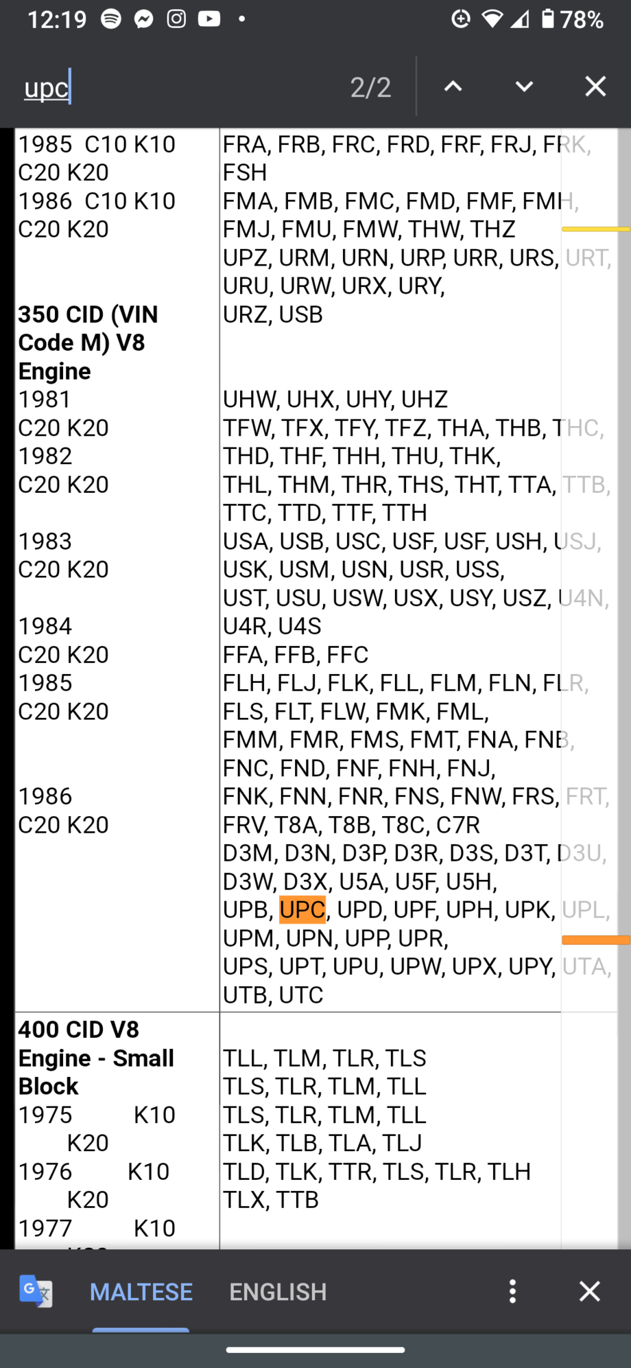

I am sure about the code being upc, I found it recorded here as this after a lot more research
Still not sure about the accuracy of that though

The sites I was looking at are more geared towards older sbc stuff, so your
UPC is probably right then. If you have centerbolt valve covers, likely 87+ if it looks like it hasn't been messed with. One of the threads I saw about this block said "no provision for fuel pump" so I'd assume the hole isn't drilled for the mechanical fuel pump. If the hole is there, 1986 is possible, if not definitely 87+ when the TBI treatment and electric fuel pumps started in trucks.
