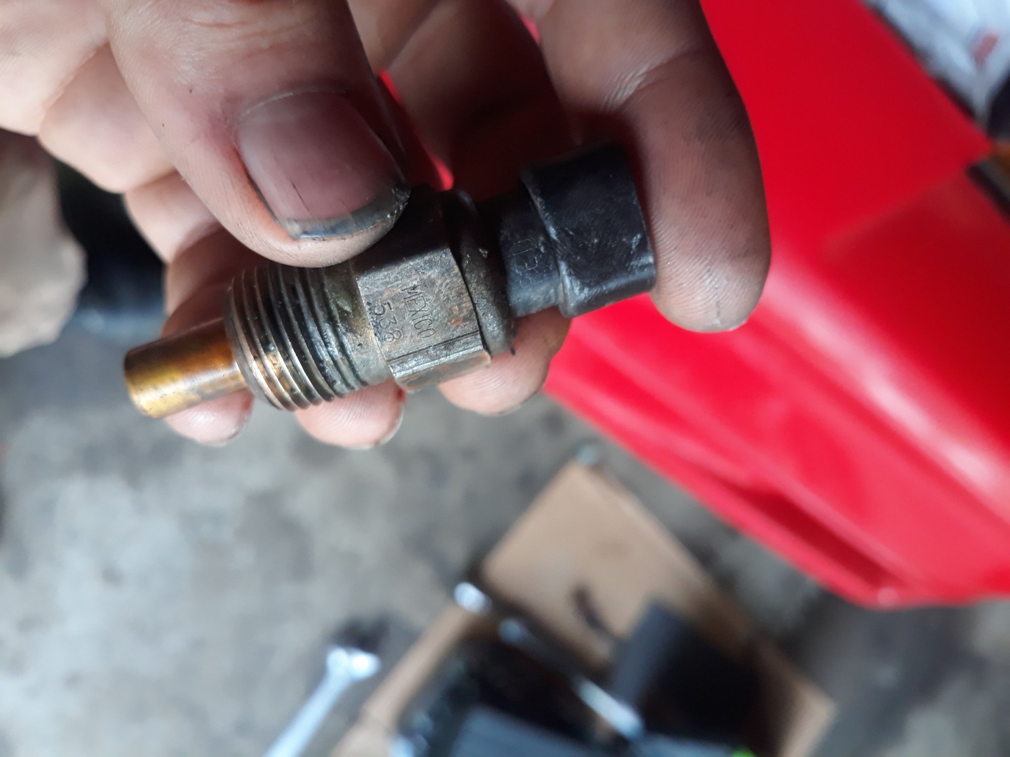

Hey everyone, I've been assembling the top end of the 305 in my 1986 Trans Am and have now come to the stage where I am beginning to bolt on accessories, exhaust manifolds, and carb. Included in the build are a set of World Products 305 S/R heads, Edelbrock Victor Jr intake, and Holley 750. As such I am converting to an Accel vacuum advance HEI distributor and I think effectively relieving the ECM of its engine management duties. Today I torqued down the new thermostat housing and noted that on the old housing there was what I think is a coolant temp sensor (pictured) threaded into it. This got me to thinking about the fact that the new heads and intake have no provision for the factory coolant temp sender (for the gauge) which I believe is threaded into the factory intake as well as the fan switch which threads into the side of the factory driver side head. Would it be possible to relocate the sender and switch elsewhere? Thanks in advance.

I'd also like to mention if it is of any help that this particular car is, or was, an LG4 car with the T5 transmission.

You no longer need the ECM sensor.
This is a 305. Why a Victor Jr and 750 cfm Holley? Too big.
Ah, somehow I didn't notice the threaded holes until you pointed it out. Doh.
