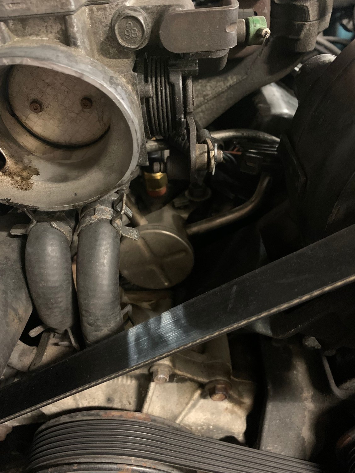

Hope someone on here can help me. My sons 92 RS has a hairline crack in fuel line right below throttle body. I have attached a picture of the round part with what looks like a plus sign on it where the lines run through. Not sure what its called. Line is cracked right where it goes in to that part. Its the pressure line. My questions would be what is this part, what does it do and where can I find it? I'm assuming I'm going to have to replace entire thing. Any help would be appreciated. Thanks

The can is a fuel pressure pulsation damper. Most likely the only place to get one is a junkyard.

Thanks RBob. Looks like I need to go on a junkyard search. Appreciate it.
