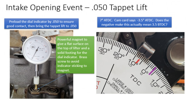

Please post some pictures of what the pointer is showing on the degree wheel.
Also the cam cards. Do the cards have "checking" numbers printed on them?

LSA on this cam is 114. With 4 deg advance I should read 110, no?
Here's my entire process documented. And yes I only approach measurement points in the clockwise direction.
https://nastyz28.com/threads/cam-tim.../#post-3871926

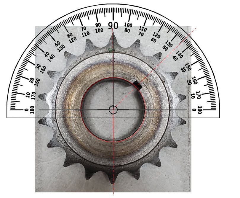

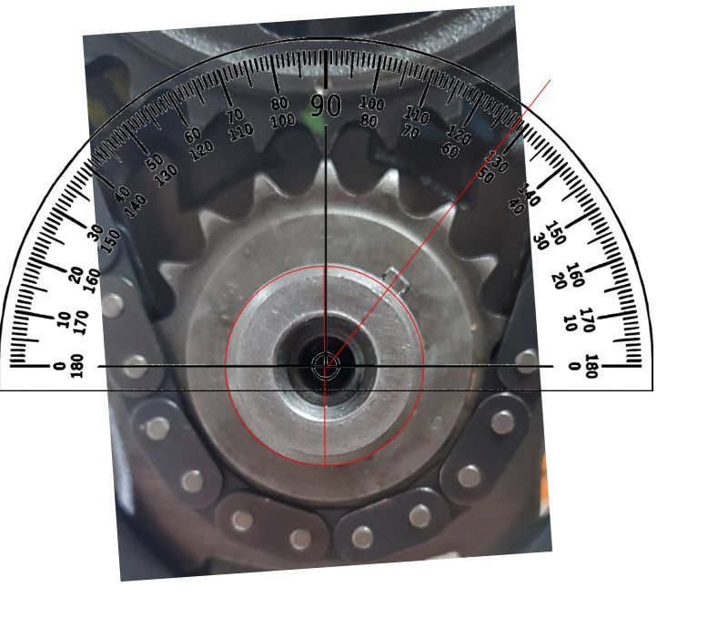

You have used that GM timing set for all of these measurements, correct?
I suspect that the timing set is mismarked. 1 tooth on the cam gear is 10° IIRC.
If I am right, then there should be 36 teeth on that gear. I suspect the dot got marked 1 tooth off.
So indulge me here - the purple line is where you should be - nearly 10 degrees off.
Reset the timing set to be 1 tooth off to get the pointer to match the purple line. Forget about the dot.
Then recheck everything again to see if it agrees with the cam card. I suspect you will only be within 1 degree off.

I'm getting a 20 deg change at the degree wheel for one tooth of shift. Which makes sense... 10 teeth on the crank gear... 20 deg per tooth.
For the intake open event, cam card says 3.5 BTDC.
If I move the cam sprocket 1 tooth CW, I get 27 deg ATDC. One tooth CCW gets me 13 ATDC. Dots lined up I'm at 7 ATDC.

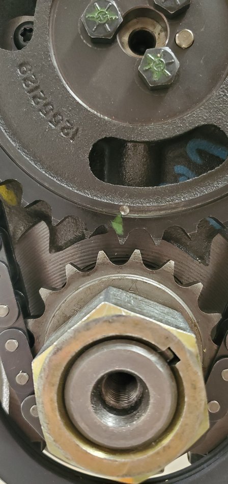

I had bought a Cloyes adjustable timing chain set and decided to try it out this morning. Supposed to give -4, 0, and 4 crank deg adjustablility.
Something seems off though...
When I have the piston at 0 TDC, the dots are lining up like the photo below. However the instructions are showing the crank dot at 12 and the cam dot at 6.
In order to get the dots to line up like the instructions I have to rotate the crank 4 deg CCW from TDC. Maybe that's where the 4 deg advance comes from?

Looks to me like both the cam and the crank are somewhat past TDC in your photo. Might wanna try a straightedge between the centers of the crank and cam, for more precision. Might have been A Good Idea to verify the crank key location before the heads went on: the keyway is supposed to be EXACTLY aligned with the #1 rod throw, which if the block is bored right (cylinders not offset one way or the other as they often are) then it should point EXACTLY 45° past straight up (1:30) when #1 & #6 are at TDC. Obviously if that's wrong, then everything to do with the timing set and its "marks" is going to be skewed as a result. Or if they're not on yet, go ahead and do that.
If there were 10 teeth on the crank sprocket, then each tooth would be 36°. (the new math: 360 ÷ 10 = 36)
Looks to me like there's ALOT more than 10 teeth on the crank sprocket, in any case. I don't know offhand how many though; I've never had occasion to count them. Looks kind of about like 20 or 22 or thereabouts.
LSA is ground into the cam. It's the amount of rotation, in CAM degrees, between the int lobe center and the exh lobe center. Can't be changed by the installer. Only the ICL is subject to that. Remember also, ICL is specified in CRANK degrees, but LSA is given in CAM degrees. Each of which is 2 crank degrees.
20° would only be right if there are 18 teeth on the crank sprocket and 36 on the cam one. Which might be true as far as that goes; you can count them and see. Then, 1 tooth on the cam would be 10 degrees of cam rotation, which is also 20 degrees of crank rotation.
If you have to rotate the crank 4° past "the right place" to get the cam to "the right place" intake lobe centerline), then the cam is RETARDED 4 crank degrees from "the right place". You need 4 more degrees of "advance".
Keep in mind also, as the engine breaks in and wears and ages and the chain "stretches", the chain DOES NOT tighten up. The ONLY direction in which the cam timing will change, is to RETARD from wherever you left it at installation. If you're doing nothing but racing it, i.e. it will get VERY FEW miles put on it, then that's probably not a real big deal. For a street car though, you probably want to install it something around 4° ADVANCED from wherever you think it should be (the cam mfr's recommendations for example), such that as time goes by and things slacken up, it will end up near about where it was designed to be. Otherwise, if you put it at that spot at installation, after a few trips to the moon and back, it'll be significantly retarded, for the whole rest of its life. IOW it'll be right for the first day or 2 then retarded for forevermore.

interesting comparison between the L31 gear and the Cloyes "factory" setting...
The Cloyes is the installed one and the L31 is out by itself... There's a ~5-6 deg relative retarding on the L31 relative to the factory setting on the Cloyes. Which probably explains how the L31 resulted in a 106, and the Cloyes 4 deg advance resulted in a 108.

If you have the chance, redo that last image (Cloyes) with the crank key at the 1:30 position for an apples-to-apples comparison.

Leave the protractor as it is, but rotate the crank so that the woodruff key is where it is in the first image - on a clock, the 1:30 position.
In other words, make the two images match. Then you can do a true comparison. It looks like you need to rotate the crank 120 degrees clockwise to do this.

Oh the reason I did it this way was to get them keyway on the crank gear into the factory position. Which is the true apples to apples.
if I put the key on the crankshaft in that position it wouldn't be in the factory position.

You need #1 to be at TDC, which is when the key is at 1:30.
Your gear has 3 positions - 0, -4, and +4 degrees.
Each position will have a different "dot" symbol at the 12 o'clock position.
Make sure that tooth aligns with 90 degrees on the protractor.
You're a little off here, but this is what I need you to do. The "dot" at 12 o'clock will be an "A". Line that up and see what the protractor reads.
This image above is with the piston at TDC. The image below is with the cam sprocket dot lined up with the triangle on the crank sprocket. The triangle represnts the 4 deg advance position.
I tore down the setup this morning, re-set everything up, re-established TDC at the piston, then remeasured everything again this morning and I'm still getting the 108 ICL and the same intake/exhaust open/close events. Just to make sure I wasn't going crazy yesterday.

I think you are saying advance and retard backwards. Lets say the spec is 110 ICL. If it drops in at 114 ICL that is 4° retarded. If it drops on at 106 ICL, that is 4° advanced. My L31 timing sprocket has 5° advance built in. That 5° of built in advance is probably why so many people that cam L31s think they cannot build good power on the top-end. Drop a cam in it that is ground 4-5° advanced and it is suddenly 10° advanced and acts way smaller.
There are also two different L31 timing sets. The later ones could have negated the 5° cam advance and been why the HP rating changed in 97. 250 hp in 96 and 255 hp in 97.
Your protractor angle is off on the Cloyes set because you are not measuring relative to the keyway slot you are actually using. Your crank is 1/3 turn off from TDC. Need to measure from the keyway slot you are using to drive the sprocket.

BTW, the 2 images below show the apples-to-apples comparison I was looking for.
This clearly shows the 5 degrees advance built into the GM L31 timing set >>> 51 vs 45 degrees.

First, GM never altered the Timing-Sets with any Valve-Event Advance.
Second, the Crankshaft Sprocket alone can not be used to establish an Advance or Retard.
Both the Camshaft Sprocket and Crankshaft Sprocket have to be used for comparison.
If that GM Crank Sprocket is (lets call it 5 degrees for simplicity) advanced...
The GM Cam Sprocket may be 5 degrees moved, compared to the aftermarket Gear-Set.
Both Gears are needed to establish Cam to Crank relationship/ position.
I wonder...
The positioning of the dowel hole directly opposite one of the bolt holes appears to be typical, as well as alignment of that hole centerline to the teeth. It seems like all the cam timing is controlled by the relationship between the keyway on the crank sprocket and the teeth.
What I know for sure is that the L31 timing chain set advances the cam by 4-5 deg over what the cam grinders appear to expect to see out of factory setting.
This the L31 cam sprocket that I currently have.
This is a Summit brand sprocket, part of a double roller adjustable set that bought, but will be sending back since I don't need it.
This one is an image of some SBC sprocket I found online...
Even the LS cam sprockets seem to follow the same basic formula?
