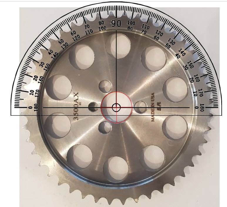

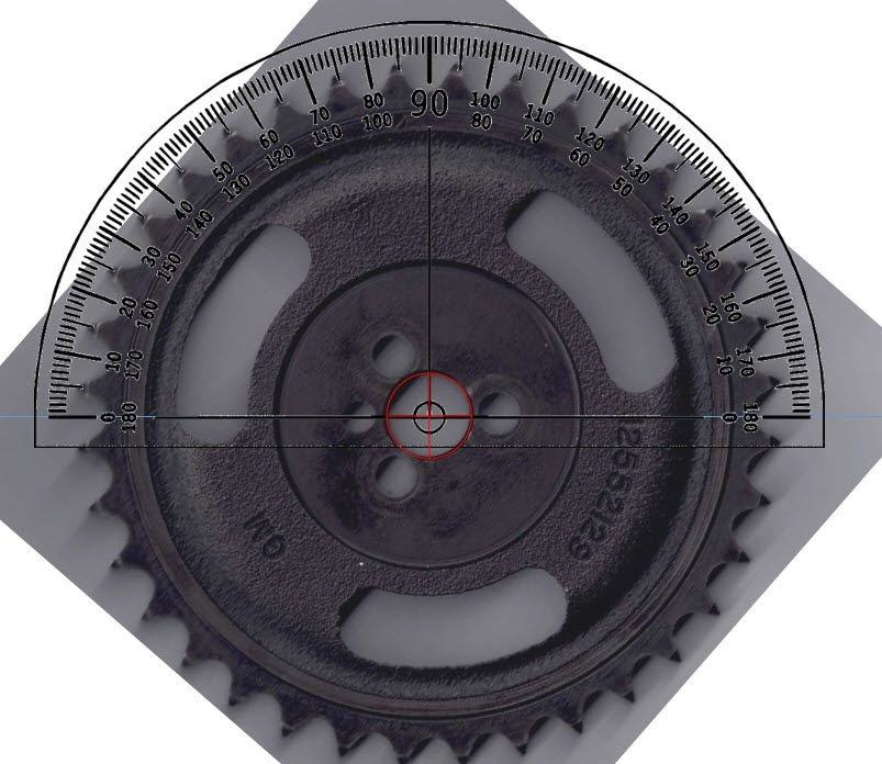

Originally Posted by ULTM8Z
I wonder...
The positioning of the dowel hole directly opposite one of the bolt holes appears to be typical, as well as alignment of that hole centerline to the teeth. It seems like all the cam timing is controlled by the relationship between the keyway on the crank sprocket and the teeth.
What I know for sure is that the L31 timing chain set advances the cam by 4-5 deg over what the cam grinders appear to expect to see out of factory setting.
This the L31 cam sprocket that I currently have.
This is a Summit brand sprocket, part of a double roller adjustable set that bought, but will be sending back since I don't need it.
This one is an image of some SBC sprocket I found online...
Even the LS cam sprockets seem to follow the same basic formula?
The Timing-Mark is not clear in these images...
The Dowel location without the Timing-Mark shown, does not help.
At least one of the Images clearly shows the back-side of the Gear...
and there is no Timing-Mark normally on the back-side.

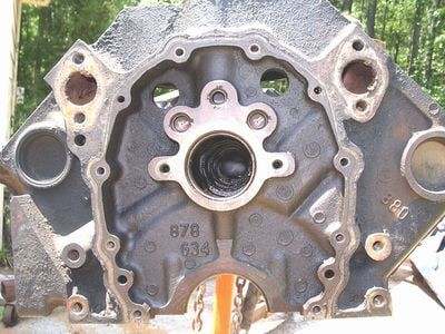

It is going to depend on the Casting used for the particular 1996+ Vortec Cylinder-Block...
and the Brand/ Design of the Double-Roller Timing-Set.
Most Castings will resemble the image below...
Where the surface for the Oil Passage Plugs, is the same surface for the Camshaft Retainer Plate.
The area just above the the center positioned Oil Passage Plug, most often needs to be clearanced.
Not all of these Blocks look like the Image above.
When I Purchase these Blocks in person, I try to pick the one that resembles the Image below:
There is already additional clearance in the area of concern.
I personally find that...
When using a Timing-Set that uses a Torrington-Bearing, instead of a Thrust-Surface with Oil-Grooves...
Less, or no clearancing will be needed.
Also some of the Vortec Cylinder-Blocks sold over the Parts-Counter, resemble older Roller-Camshaft Cylinder-Blocks.
Shown below is what the older Cylinder-Blocks looked like in comparison:
The Surface for the Oil Passage Plugs is recessed compared to the surface for the Camshaft Retaining Plate.
