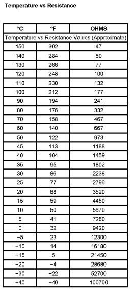

Ok so I did the paperclip test and got a code for coolant temp sensor, circuit 'low or open'. according to https://mechanicbase.com/trouble-code/obd1-codes/
So should I replace the sensor or is it something electrical

Use a ohm/multimeter to check the resistance of the sensor first. Could be bad wiring, could be a bad sensor. On the far side, could be an ecm.
