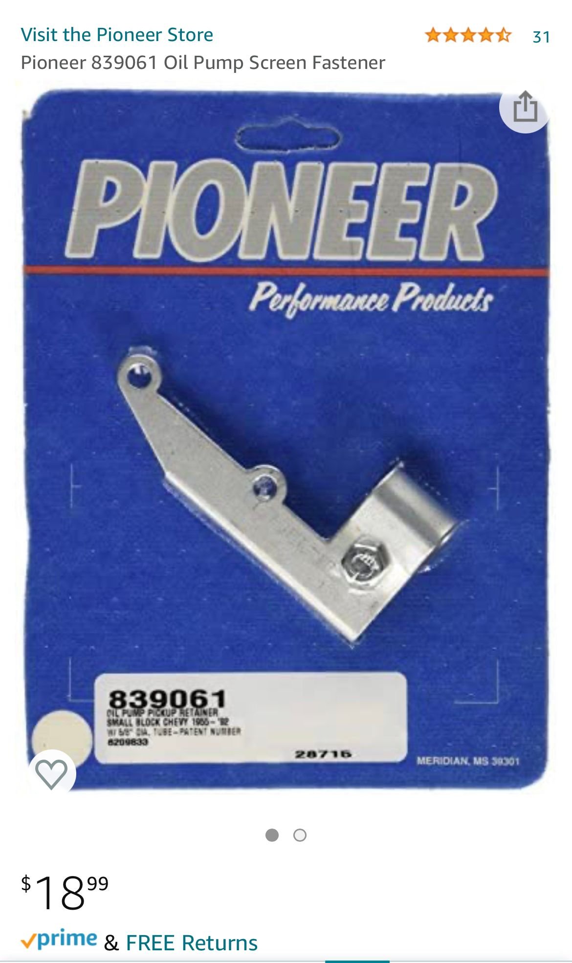

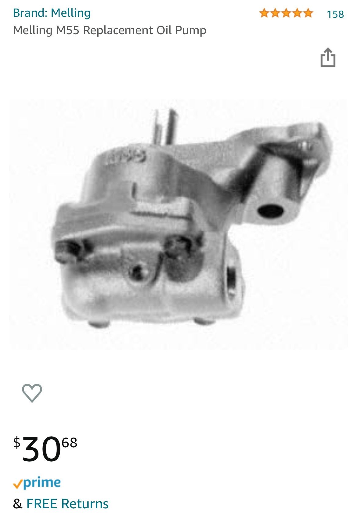

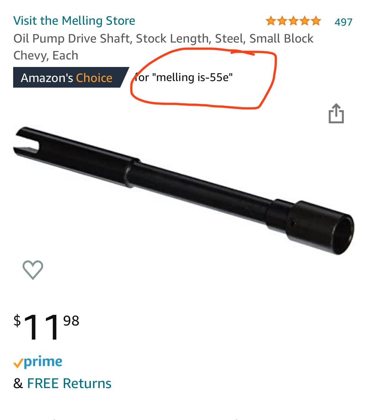

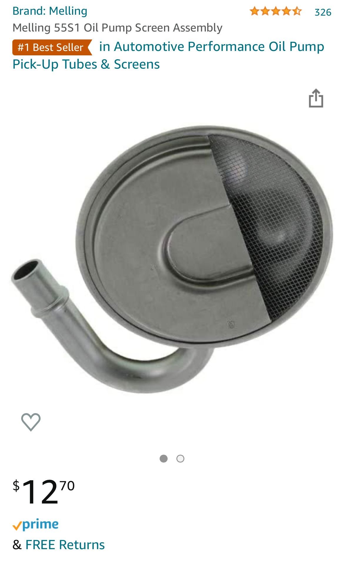

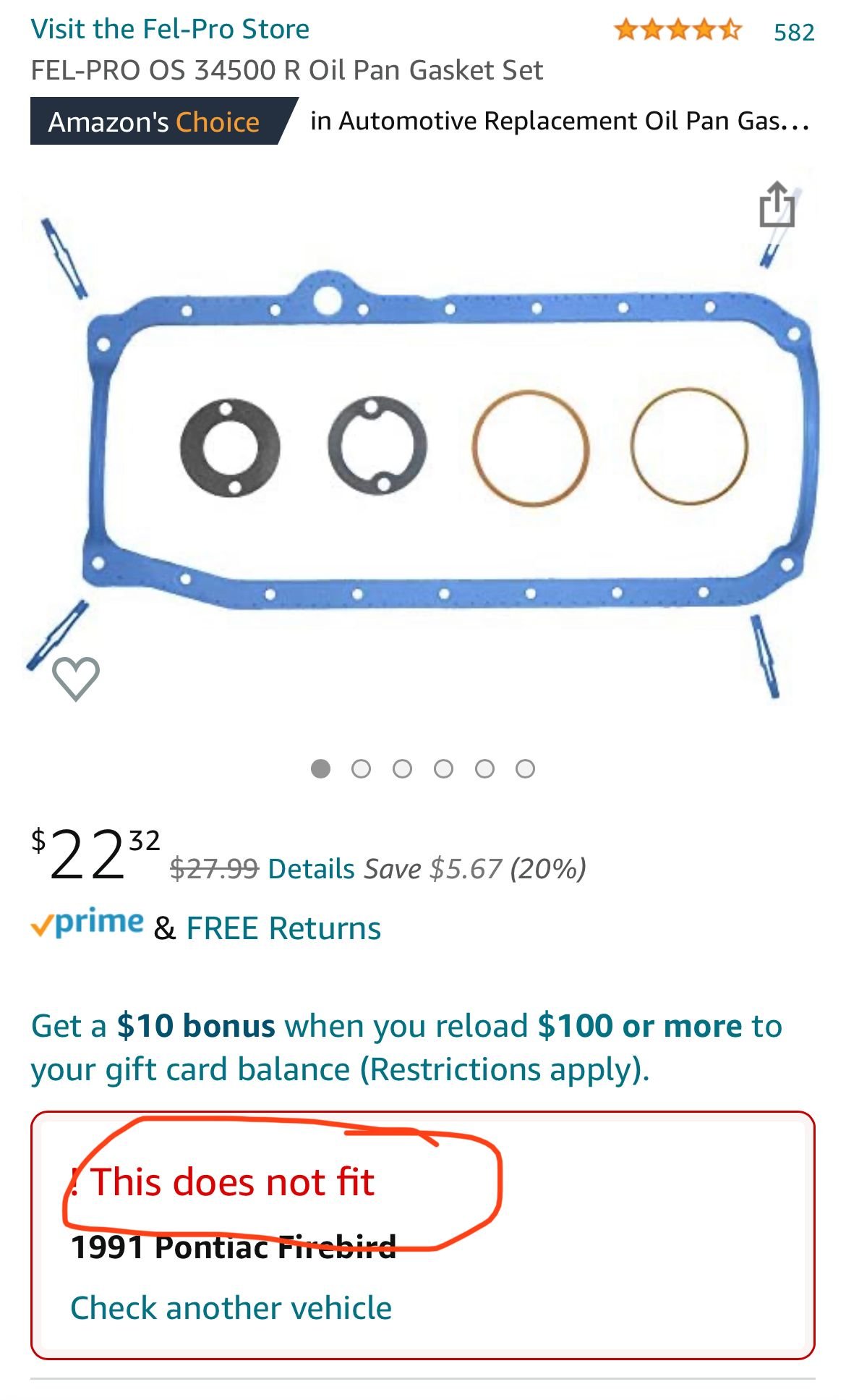

Lookin to check if there’s any foreseeable problems with the parts list below for a stock bottom end and stock oil pan 88 L98?
I’ve got a leaky oil pan gasket that I wanna replace, while I’ve got the whole front suspension torn apart I’m going to remove the k member to sandblast and powder coat it, Now would be the perfect time to go ahead and fix on that leaky oil pan gasket and if I’m removing the oil pan just as cheap insurance I’m also replacing the oil pump and related parts. So do you see any issues with parts listed below? Is there anything else I should consider?
For some reason Amazon Is saying that this gasket kit doesn’t work but Felpro’s website says it does, certainly wouldn’t be the first time that Amazon doesn’t know what they’re talking about.
Has anyone used these before?

M55 is the std pressure version. will do about 35 - 40 psi hot cruise in a motor with new stock bearing clearances.
M55A is the one to get. It's the replacement for the ones in motors used in "sporty" cars like ours, Vettes, MC SS, etc.
Or, get the Mr Gasket relief spring, and put it in the M55. That more or less turns it into the A.
Otherwise, should be fine.
As cheeeeeeep as all those parts are, I see no reason NOT to change them, even though it's very true that the existing ones are most likely just fine. The things that fail most often about oil pumps are, the plastic sleeve that the E drive rod fixes, and the screen plugging up, and the relief valve hanging up on debris. Needless to say it's ALOT easier to unbolt old and rebolt totally new, than to take the old apart and repair or replace those things.

replace the pump if you want to. no big deal. but the only thing I see with your listed items is the pickup retaining bracket. I'd much rather braze or weld the pickup tube in place at the pump.
You can mock everything up and then carefully take the pump back out and have it brazed.
I say 'brazed' because it is a steel tube and cast iron pump housing. Yes, many many people have just welded the tube to the housing. However cast iron welds are brittle and can have problems.
So, I personally TIG Silicon Bronze to do that instead of weld. but an alternate method would be to make a tab that bolts to under one of the pump housing cover bolts and then welds to the tube. that way you can MIG it (away from the engine), not weld to the cast iron, and could also remove the pick up from the housing if you ever wanted to for some reason. Just a thought.
example of a Canton pickup. you can see the tab w/ the bolt hole.
