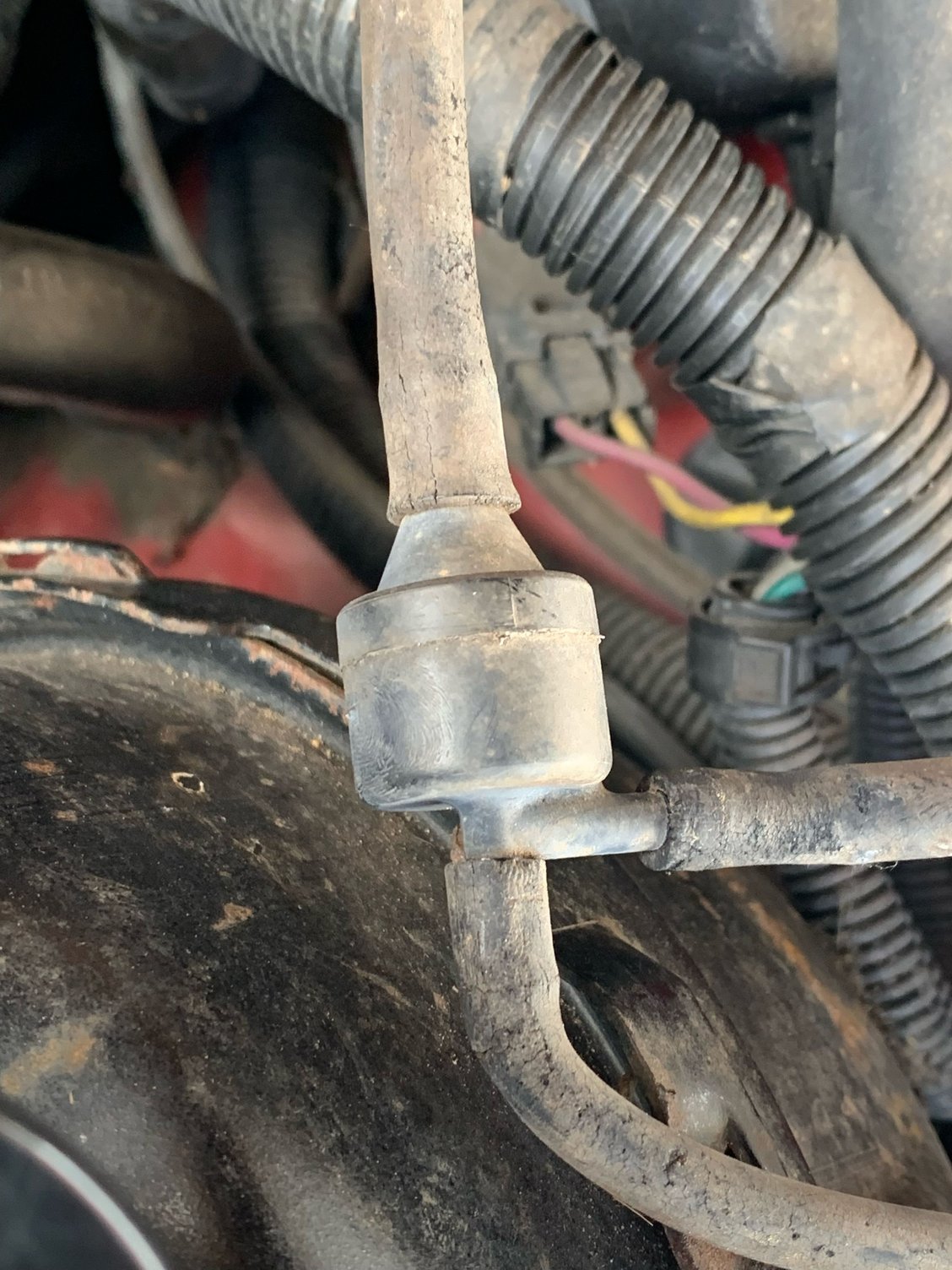

Hello, I was just given an 86 trans am and I am trying to fix it up. I found this with both of the tubes on the side being cut. So I don't know where it goes and what it is to replace it. I look on the device to see if I could find a part number but no luck there. I was hoping that someone on this forum had an idea of what it could be?

Vacuum t, check valve for hvac/cruise

I have check valve like that on my 86,it is used for my windshield wiper fluid,but mine only has 1 port in 1 port out not two.
edit I also have both of those check valves one for the cruise control and for the wipers.
