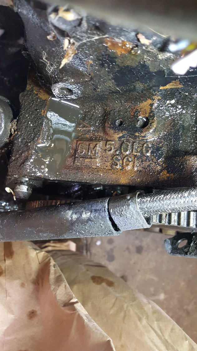

What is this engine stamp?
So I pulled this motor out of an 87 truck. I went looking for the engine stamp code so i could learn a bit more about it before I started tearing it apart, but when I looked at the back ledge for the code, all I got was this...
Now this clearly isn't the casting number I was expecting, and I couldn't see anything on the passenger side ledge although there's a good bit of wires/pipes/lines/tubes on it still that were kind of all over the place so I might have simply missed it. Is there any information from these numbers other than its obviously a 305? Is there a chance the casting number is somewhere other than the back ledge like I am used to?

It's a 305 block. That's about all that tells you. At the end of the day, that's the only thing that you need to know from block numbers. Anything of actual importance those block casting numbers won't tell you anyway. Roller cam? Won't know till you look. 'Good' heads? Won't know till you pop valve cover and see what they are. What pistons/rods/crank are in it? Won't know till it's inspected. It's had 30 years of life probably at this point and could have been changed to something it didn't leave the the factory as.
It only implies that its a 305 still. It really only tells you it's a small bore sbc.

That's not a "stamping".
Here's the usual place, just like your pic:
Might want to look a little to the right of your photo.
You might also find the last 3 digits here (above and to the right of the crank)
and/or on the side of the block or on the front although that last might be under the timing cover.

Guess I should just get to disassembly then. I have a 350 goodwrench block next to it, was gonna build that but its a completely bare block, doesnt even have the main caps anymore, but I did get the full heads with it. I was comparing prices and decided to go for this 305 since its a complete package and work with it til i have the time and funds to build the 350 properly. No sense slapping together weak parts on a good block when i can use a 305 til the 350's done . The most annoying part of the 350 block is that although its a 4 bolt main, all 4 bolts are straight and all the 4 bolt caps i've found locally are the standard ones with the outer bolts at an angle. Gonna be some time til i can fix that fella up.

Take the flex plate off to get the last 3 of the block casting #. Will also tell you whether it's a 1-pc or 2-pc rear main seal, if you haven't got to that point yet.
Take the VCs off and get the head casting #s.
