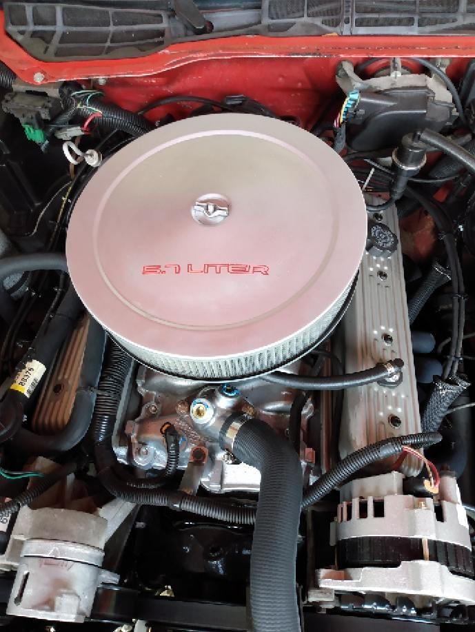

Re: Would it be better to swap out the 305 or swap a 350?
Go 350..You wont be sorry. I got this L98 for a song and replaced my L03 with it.
