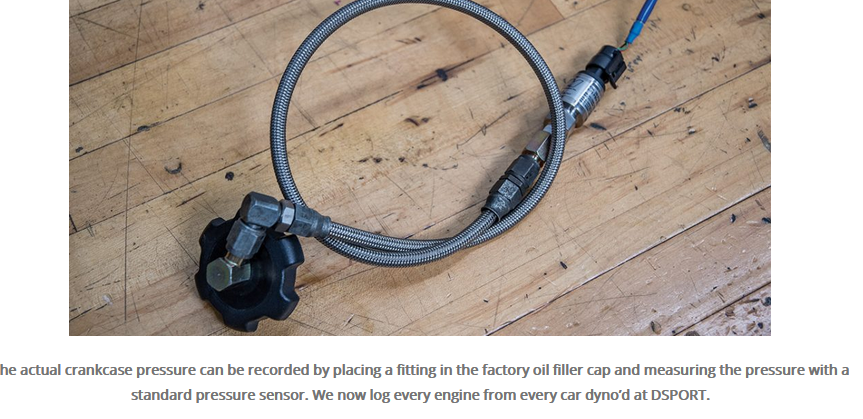

Heres how alot of people do it instead like for dyno, just get a spare oil cap and drill/tap the cap for the test. then put back the old oil cap when finished.
You can make 12v into 5v using a small voltage converter device, something like these.
eBay item number: 384892160106
eBay item number: 114720734903
Most USB devices are 5v so you may have one already.
I recommend using a OEM 1-bar map sensor from a Chevrolet vehicle with the 5v input from one such device, keep the power separate from the car power, provide with a different battery.
For example I use 6x AA batteries to make 12v input to my step down to 5v. You don't want the car battery input power because it could influence the results during WOT when alternator voltage snakes around.

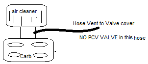

Do you have pictures or any information on how to connect a line to the air filter?
You just need something between the filter and carb with an attachment for the hose
Quick paint draw
At WOT the pressure between the filter and carb butterflies will drop based on the air filter flow rate. This suction pulls on the crankcase, pulling blow-by out of the crankcase, producing a pressure drop inside crankcase which prevents oil leaking, and protect oil quality.
Air filter flow rate is setup to provide the desired pressure drop at WOT
For example if the air filter flows 500CFM @ 0.5" Hg pressure drop then when the engine is flowing 500CFM the crankcase will be supplied 0.5" Hg which is just barely enough
IF you install a 800CFM air filter and the engine only uses 500CFM then it will not develop any pressure drop at all, crankcase pressure will rise and the engine will begin to blow oil
Thus the air filter flow rate is a SET value based on crankcase pressure requirement, desired crankcase pressure is set by air filter flow rate pressure drop
Another example, air filter flowing 450CFM total and the engine uses 500CFM is perfect, it will develop a 1.0" to 1.5" Hg pressure drop and protect the engine.
Yes this will cost power but the choice is either power supplys PCV action and protects the engine and prevents oil leaking, OR You sacrifice the engine health and allow oil to blow out from the engine (Catch oil in a catch can and blow oil from every seal) and get the full power of the engine.
Alternatively you can use a vacuum pump to get both the power AND crankcase pressure drop, but vacuum pumps are unwanted extra maintenance and potentially unreliable for long term daily drivers.
However there are even more solutions available, such as exhaust driven PCV and electric vacuum pump driven PCV.
Bottom line is no matter what you choose, the crankcase pressure needs to be measured, and set purposefully. Just like a fuel pressure setting. Never assume
