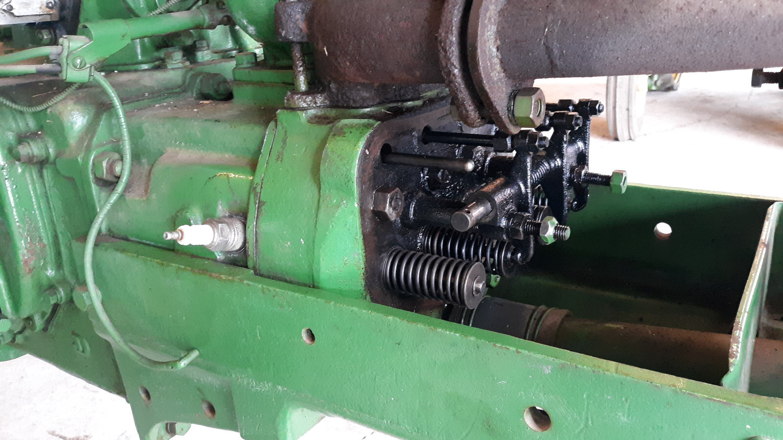

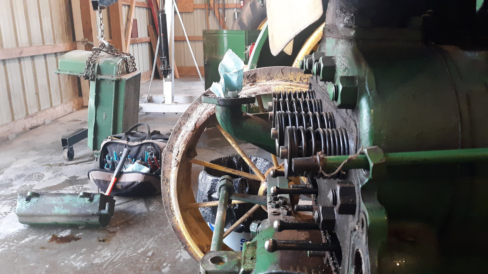

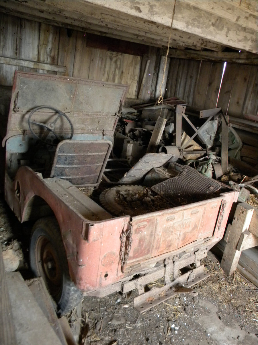

As for mechanical problems ten years may be enough to create stuck valves, scaly cylinder walls, and leaked-out lifters. I know that 40 years of storage certainly can. I am currently in the process of resurrecting twenty-some antique tractors, the latest of which haven't been run since 2003, and some that haven't run since 1973.
Stuck valves can happen:
Some are so stuck that they break rocker arms:
That should only underscore the advice to check for any mechanical anomalies on startup.
