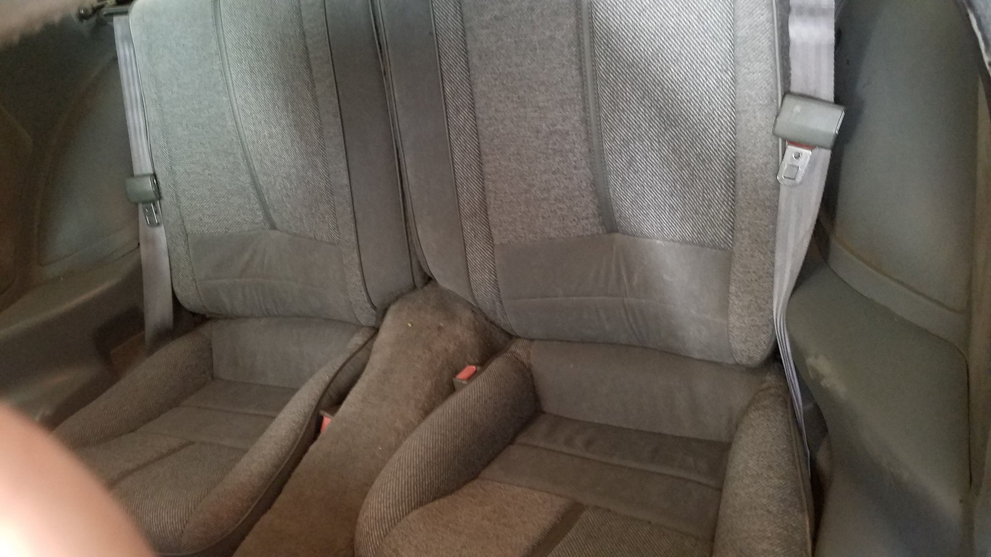

Hey guys! I just got a 1992 Z28 with the 5.7 350. Its been sitting in a garage for over 14 years! 1 owner with 106,000 original miles! All the fluids look surprisingly Good! I put some fresh fuel and a battery and she turns but won't fire! I ran out of daylight and wont have time to work on it over the next few days. AGHHH! 😓
I'll run through the basic checks to see if I got fuel and spark and we'll go from there! Stay tuned cause I may be back with questions or hopefully a running Z28!

GOOD NEWS! The Z28 fired with the help of some starting fluid. It ran for a few seconds and died. Here's a few more pics.
