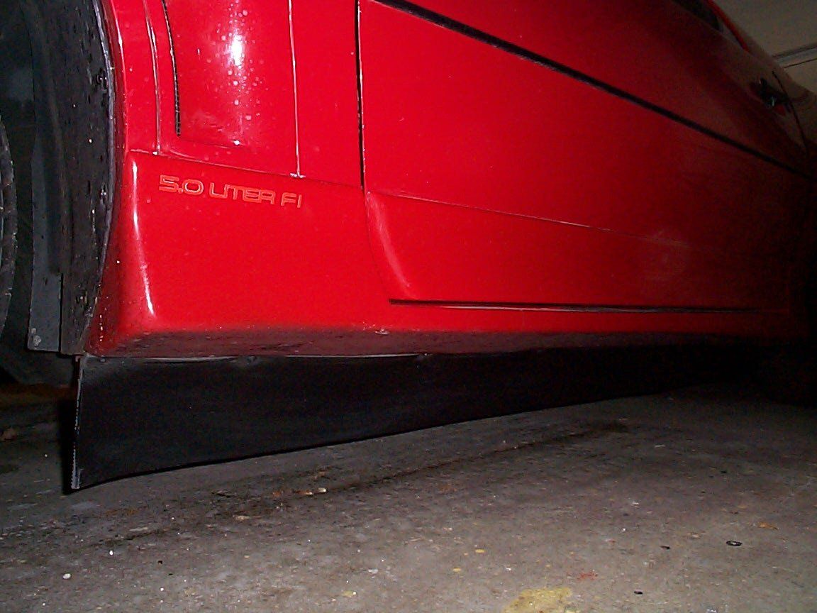

No, unfortunately the trim on this car overall is too big. It's blocking all the room for the jack and our current jack won't bring it high enough in the front to put the stands under it. We pumped it all the way and the stands wouldn't clear in the spots where they are safe to put. Thankfully my car's plug don't cost too much here so it shouldn't be too big of a deal to have my usual dude do them We are definitely leaning towards a cracked plug or something. If that doesn't fix the issue then I am absolutely mind boggled. Another thing that swayed us towards plug was I contacted my transmission guy and he said it sounded more like a misfire was happening not the torque converter struggling.

This is off topic, but do you guys have any idea what the trim on the side is called? The one that goes along the side of the car beneath the door? Mine cracked and wanted to replace it.

Below the door is the rocker panel. For cars without a ground effects package, there is an optional plain rocker molding (unless you're in England, where is is a moulding).
For cars with the ground effects package, there is a contoured urethane piece covering everything from the fender wheel opening to the quarter panel wheel opening, and bonded to the rocker panel. There is a mating section bonded to the lower portion of the door.

I think mine is a moulding. It's a long strip that is held on via nuts and bolts. Well y'all... Spark plugs gave her good power again but the ticking is still getting noticeably worse. We made an appointment with the guy who rebuilt my tranny some years ago, it does still feel like rapid shifting at certain rpm so we are pretty sure the torque converter is shot. It's not even old yet, has 60ish thou on it. Making funny noises and whatnot. The ticking is just so loud underneath the car. The guy said he would diagnose it, if it's engine we will replace it later if it's torque we will fix it asap. I will say doing spark plugs made the engine a lot smoother sounding too
