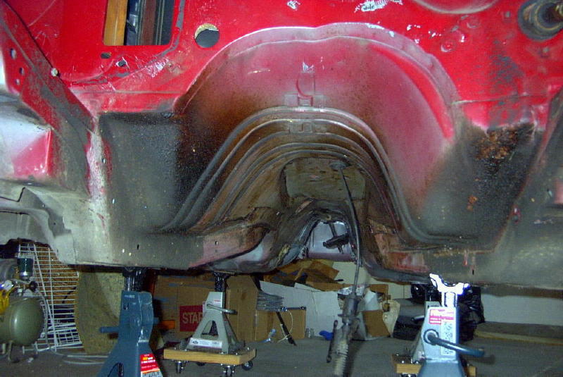

My transmission is out ... but I went from this ...

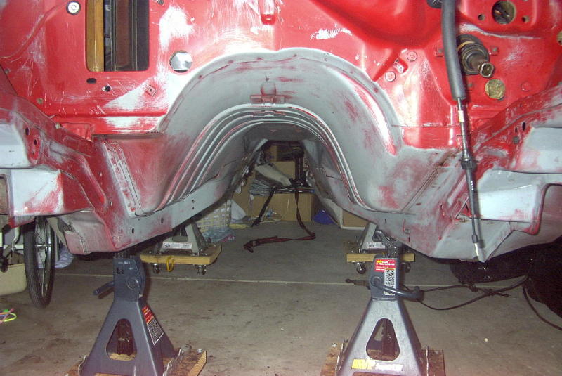

to this ... with oven cleaner.

Yup, that or brakecleaner. That's how I did mine. Follow it up with some gloss black enamel

I would highly suggest using black Epoxy paint (Appliance paint) It is much more durable for the undercarraige.
Also, Easyoff oven cleaner will remove anodizing so use caution on anything anodized.

Oven cleaner works good. Though it can and will eat paint. Its great for striping clear coat off aluminum.
Krylon sell a farm equipment paint in a spray can that is very durable.

oven cleaner works the best, then use brake cleaner for those really tough hard to reach areas

Oven cleaner takes off the undercoating?? Cool. I used Eastwood's "UnderGone" undercoat removal spray; it worked pretty damn good, but oven cleaner is easier to get!

oven cleaner strips its great, and its cheap.
thats why ive used it
